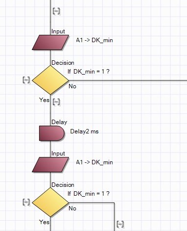

In an older program I checked an input and waited a while.
Than check it again and if it's still high, than react.
This was meant to avoid spikes but it might be better do debounce?

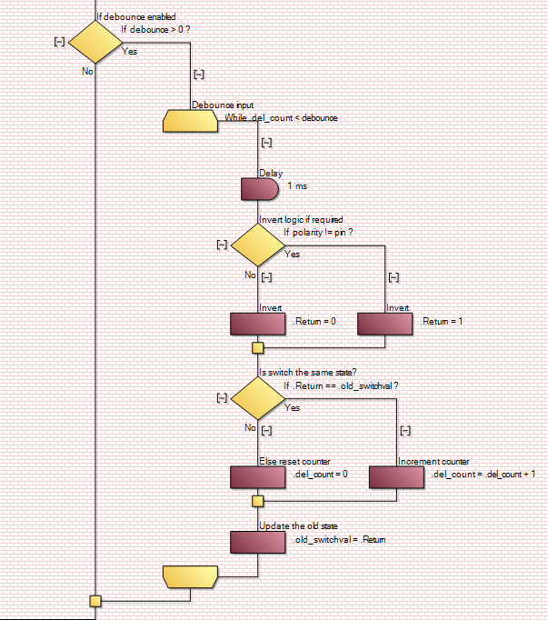

This is the debounce routine for the switch read functions: if you believe the debounce is not working then we will investigate further.
You need to rememberr that the code within a microcontroller is accessed so fast, delays or WaitUntilHigh or WaitUntilLow (depending on the polarity.), will be required to prevent switch being read too quickly
