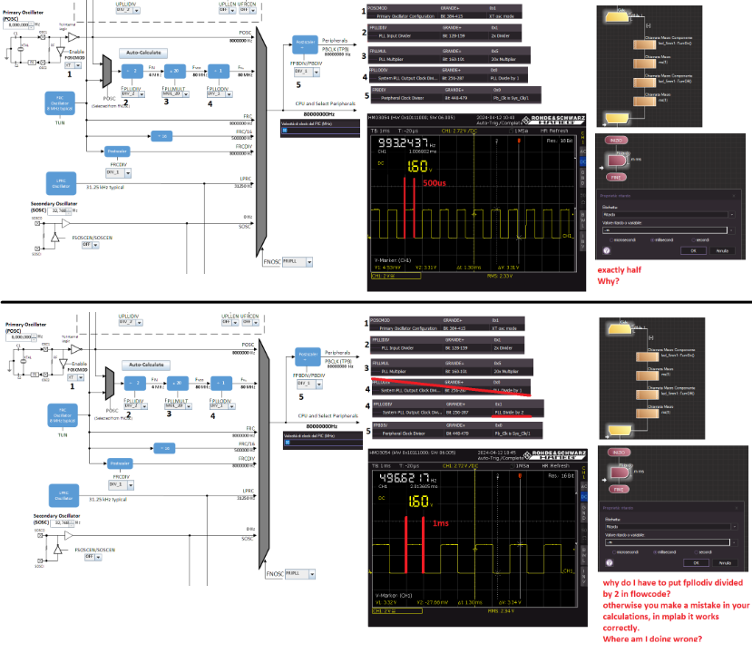

Because in flow code I have to put FPLLODIV divided by 2 to have a correct delay, with a CPU at 80 MHz.
Let me start by saying that it works correctly in mplab, am I doing something wrong in the configuration in flowcode?
Because it doesn't respect the delay
- 1can.png (237.28 KiB) Viewed 8338 times

I correctly entered the clock speed of 80mhz, it seems that it works at 160, but obviously it is not possible, surely there are some employees who don't work for me,

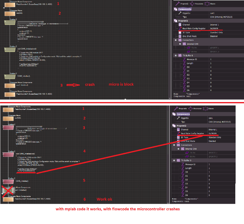

I'm going crazy to understand but nothing to do if I insert code made with mpla and working correctly, it also works in flowcode,
but if I only insert flowcode init the controller crashes, I would like to buy flowcode 10 but I doubt it would solve this problem.
I attach example photos, the project is always the same
https://drive.google.com/drive/folders/ ... drive_link

This is the simple project working tx can with rx can, I still have to understand why it doesn't want to work with flocode init, I'm waiting for someone expert to answer me.

The only blocking code I can spot in the CAN initialise for the PIC32 is here,
You could double check if this is causing the problem by commenting out the while
The code can be found here C:\ProgramData\MatrixTSL\FlowcodeV10\CAL\PIC32BIT
Copy and paste the path into your file explorer and then open the file PIC32BIT_CAL_CAN.c in a text editor.
The code in question can be found on line 296.
// Set to operating (normal) mode
C1CONbits.REQOP = REQOP_NORMAL;
while(C1CONbits.OPMOD != REQOP_NORMAL);Code: Select all
//while(C1CONbits.OPMOD != REQOP_NORMAL);Copy and paste the path into your file explorer and then open the file PIC32BIT_CAL_CAN.c in a text editor.

Hi, I commented on the indicated line, actually the microcontroller does not block but continues, the only thing it transmits and receives.
