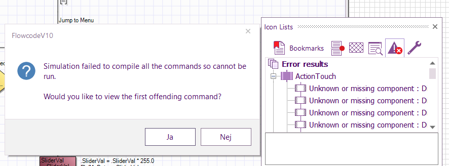

I have test your eksamble in simulation, but get these error.

Looks like you might need to update to the latest component via library updates.
I tried with the esp32s3 board (parallel ILI9488) - and got many build errors
They look like I/O related compile errors. is the display component connected correctly?
Hi Jorgen,

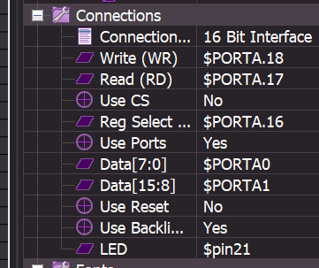

Just started to use the esp32s3 board (with ili9488 in parallel mode) - and I'm hitting this error again...
Error is as before (and in v10 and v11) - I can write to the display - but not using the component - errors occurring in ESP_CAL_IO
- a new one for me!) but compiled on second attempt - as far as I see the only difference is the write using port mode and changing this doesn't affect things ?

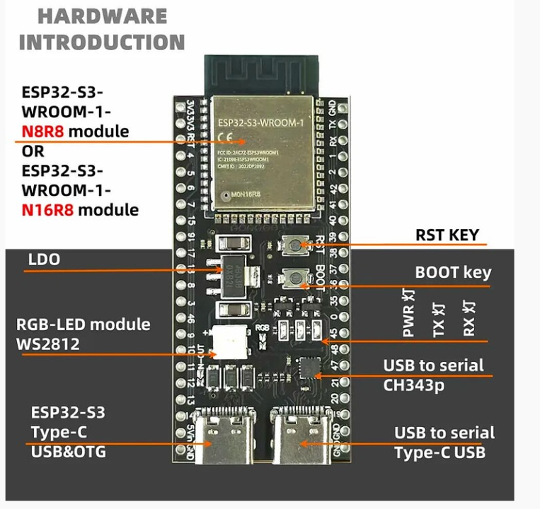

Also - how is the 'super bright' LED on the ep32s3 board controlled ?
Code - I just tried to initialise the display - so not sure which connection is the culprit? We've hit this before - see https://www.flowcode.co.uk/forums/viewt ... 5&start=10 - and my code from there works (using port A0 and A1 to write to the display in port mode) - but Ben's didn;t (C:/Espressif/frameworks/esp-idf-v5.5/components/esp_lcd/rgb/esp_lcd_panel_rgb.c:681:1: internal compiler error: Segmentation faultD:/Projects/Flowcode/Lidar_s3/main/esp-project.c21: error: expected expression before '?' token
2700 | SET_PORT_MASK(?,0x0, 0);
C:\ProgramData\MatrixTSL\FlowcodeV10\CAL\ESP\ESP_CAL_IO.h:91:78: note: in definition of macro 'SET_PORT_MASK'
91 | #define SET_PORT_MASK(p,m,v) FC_CAL_Port_Out_DDR (p, m, v)
C:\ProgramData\MatrixTSL\FlowcodeV10\CAL\ESP\ESP_CAL_IO.h:91:79: error: left-hand operand of comma expression has no effect [-Werror=unused-value]

Happy Newyear!. Concerning the LED on the board. I have worked with the ESP32 Dev board myself and tried to get the onboard LED working.
When I bought a new board, it came pre-programmed and the LED changed color as a test, so I know it is functional. When I check the pin with a scope, I can see activity on that pin.
What I have found is that the LED is connected to pin 48 and it is a WS2812 LED. I have tried to control it in Flowcode 11 using the WS2812 component, but I do not get any signal output on the pin. Based on my attempts so far, I suspect that the WS2812 component may not work correctly on the ESP32-S3, or at least I have not been able to make it work, maybe me
Jorgen.

The compiler problem is caused by the hidden pins in the component, even though these aren't used they are causing the compile errors.
Here's a fixed version of your project file.
I'll see if I can improve things by automatically assigning correct values for the hidden pins.
I'll also investigate the WS2812B as it certainly used to work but I beleive something may have changed with the latest compiler version.
