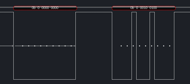

DStoyankov
- Posts: 18
- Joined: Sun Feb 26, 2023 12:44 pm
- Has thanked: 5 times
- Been thanked: 1 time
Re: 9bit UART - Arduino Mega 2560
No, it isn't.
0.511 is a float type, 4 bytes.
A 9-bit symbol is of type byte + flag bit, that is, the maximum number is 511 - b111111111.
When making a buffer of 9-bit numbers with bytes - the odd ones are the 9th bit, that is, 0 or 1, and the even ones are the lower 8 bits, but the idea is that both bytes are sent in a packet at the same time - the odd one as the 9th bit flag, and the even one as byte with 8 bits.
In the UART component I can't access the 9th bit (or I don't know how).
The Arduino environment is also not set.
- 9bits.PNG (14.71 KiB) Viewed 7669 times
