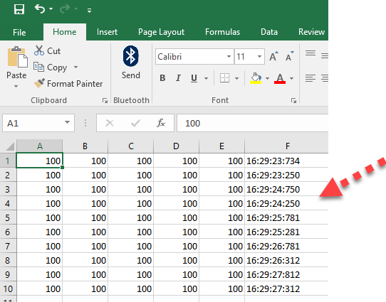

If I use CSV writer with few collum, the timestamp make problems with the time (reverse time).
If I use just the timestamp, it's working fine.

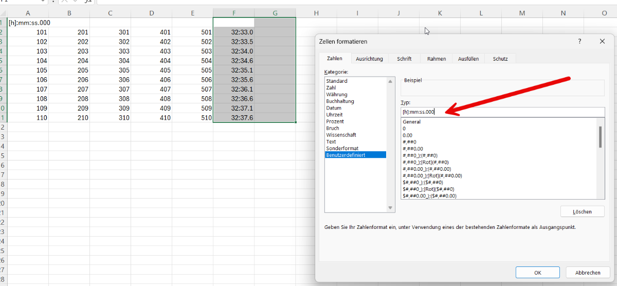

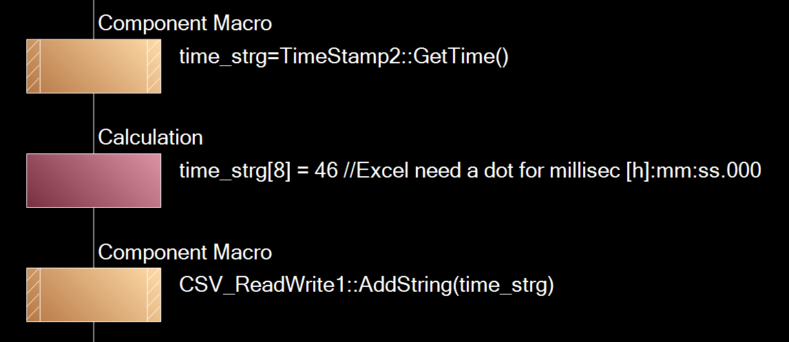

If I insert this line, i have the excel time format for hh:mm:ss.000 and i have to format the cells in excel and i can calculate time difference
Format the cells in Excel:
And calculate the time:
