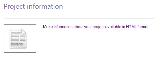

Flowcode has a nice export function and generate a html file with printscreen from all the macros and panels.
under export:

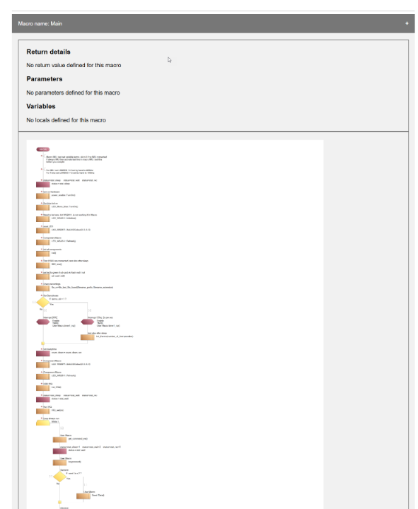

this is the main from my project:

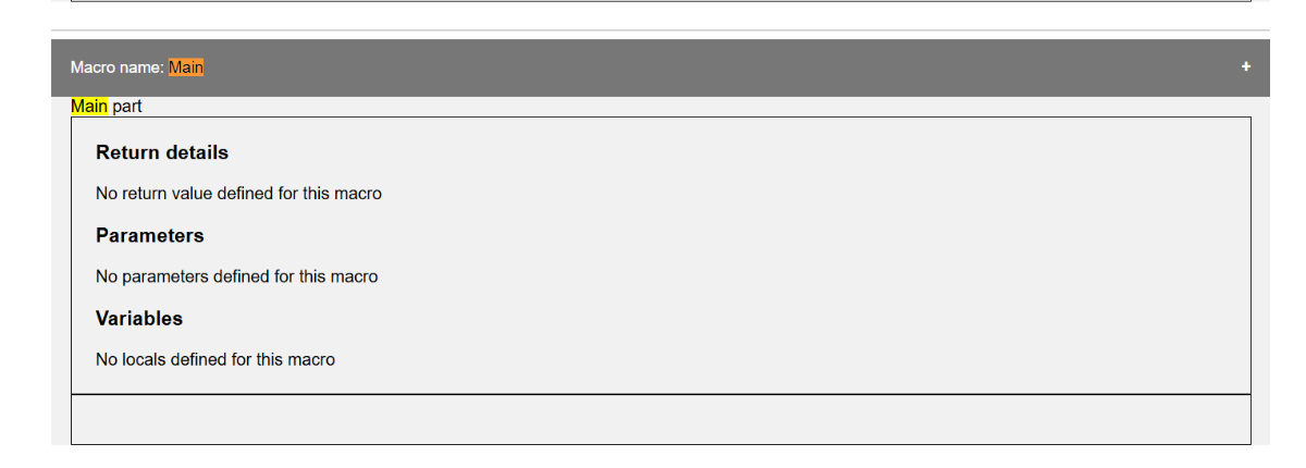

and this from the post_doku:

Sorry, but I don't know what the problem is. As you can see from my previous attachment, the macro is correctly displayed when I try.

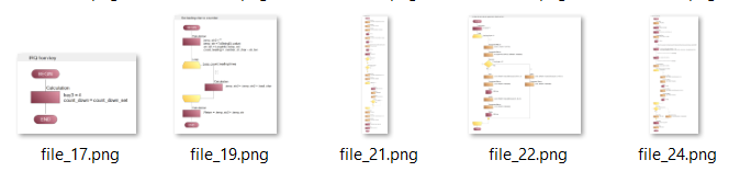

Flowcode on my computer is not exporting all the files.
I did it on another computer.
It works there too.
If I copy the missing files into the folder, the documentation is OK.

Thanks, Stefan. It seems that something is stopping Flowcode creating those image files. I cannot see anything particular in the code that could cause this though.
