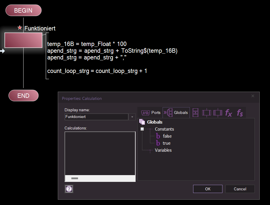

In a working program i can not change the calculation anymore. It's empty.
Before i have rename the variable from themp_16 to temp_16.
Maybe a problem?

Hi Stefan,
There is a small issue with the calculation icon window in the latest v10.1.1 version of Flowcode. If the first line of a calculation is a blank line, then the calculation icon dialog will be empty when it is opened, and if OK is then pressed, the calculation icon contents will be cleared.
The workaround for this is to always have something at the beginning of the list of calculations. If you want a blank line at the beginning of the list, then you should use "//" instead.

Any current V10 projects can be easily fixed, if you want all the lines visible again.
Keep a backup copy just in case.
Open your .fcfx project file with a text editor like Notepad++.
select Search >Replace
Within Find what: box enter
<exp exp='' />
Leave Replace with: blank.
Select Replace All
Finally Select save.
