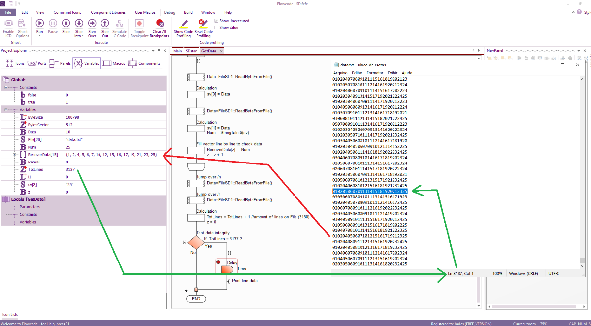

Using SD, I had problems reading data from file. I did a test now with the V10 and the problem persists in the same way, since the V8 at least. Please can someone check it? As shown in the attached image, when the read data reaches line 3137, a jump occurs and data from line 3145 is read.
The bigger the firmware or the more macro levels entering when reading from the SD, the sooner the problem will appear. In my real program the error happens on line 1200. Those are tests file only, no real data present.
It's the latest version v10 and v8 too, if anyone gets different results, any advice is welcome.

It happens exactly the same way using the GetString macro. Using same data file.
It's the automatic readable file index that gets lost in larger files or deeper levels of macros.
It would be nice if we could have access to it to control the starting point of the readings, through a component property.
