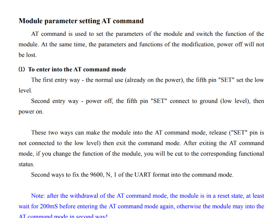

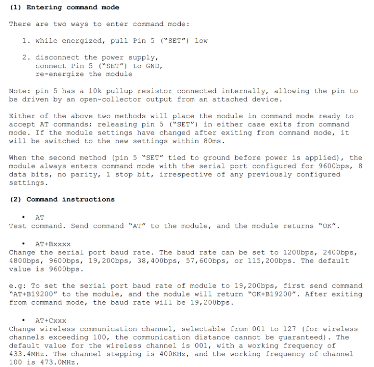

Re: CONVERT SENSORS TO WIRELESS
Hi Basil
If you want to use at commands for the HC12 you have to do something with pin 5. like Set to GND ...
- 2024-08-13_14-57-34.PNG (316.17 KiB) Viewed 3076 times
- 2024-08-13_15-02-22.PNG (279.62 KiB) Viewed 3076 times
