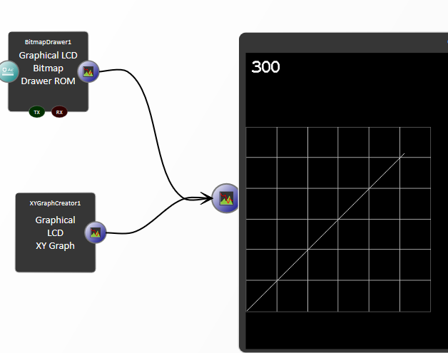

Perfect!
The XY chart now also works.
The chart looks as if it can only display up to 255 in simulation and hardware
Perfect!
