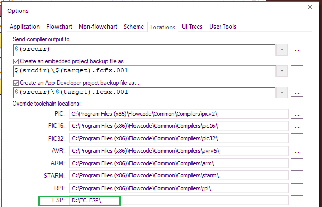

What you can do is check the path set within Flowcode.
Within Flowcode, open, select File > Global Settings.. Locations tab
Look at the ESP 32 window and correct the path.
This is mine: Make sure your ESP32 path is entered.

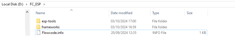

If all looks correct, then your antivirus could have prevented the installer from adding all the files.
You should see: Folder sizes:

The options have the correct path
There are more folders under K:\FC_ESP than in your example but the esp-tools and framewoks folders are the same size as yours.
