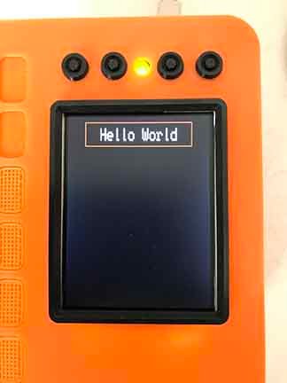

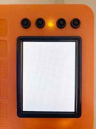

After downloading the FC V8 program to the Arduino the display operates as I expected. However, with the FC V10 program loaded the entire display is white with no text visible.
Display with V8 program:
Display with V10 program
The included flashing yellow LED indicator confirms the code is running in both FC versions. Both versions simulate correctly.
I am not sure if the problem lies with the operation of the Arduino Uno target or the display (may be a timiing problem with the SPI bus), but I have a number of the ILI9341 based displays that I would like to use with Flowcode, so it would be nice to have a solution.

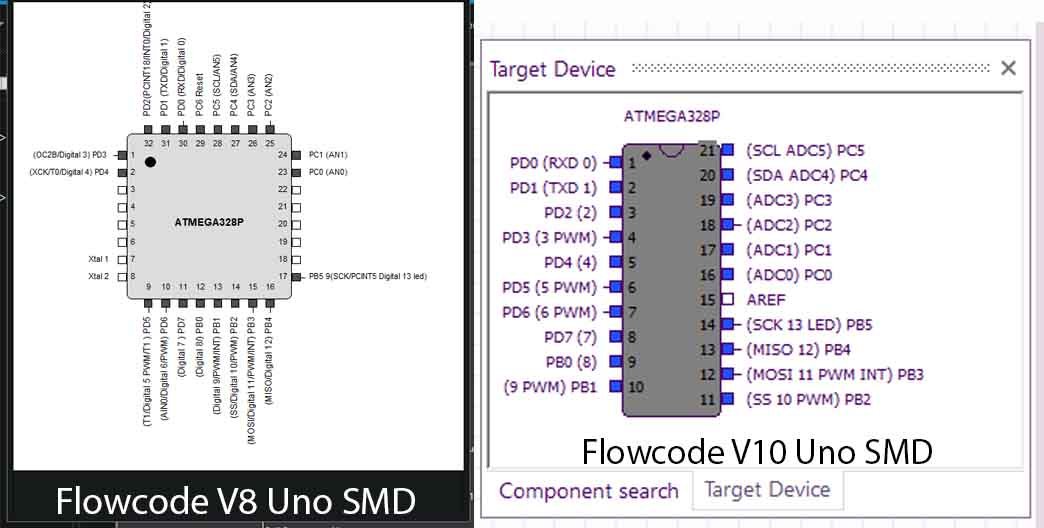

As a further observation albeit only cosmetic, I noticed the target chip view in FC V10 displays the PDIP package rather than the SMD package, Whereas FC V8 displays the package correctly.
Uno SMD Target devices as displayed in FC V8 and FC V10
Target Chip views.jpg (96 KiB) Viewed 5664 times
