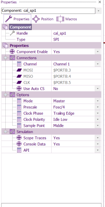

Just correct the SPI_Cal as the same as yours Martin, but still the same, only run in Softwaremode, but I cange the prcaler to /4 that speed it a bit up.
Your examble doesnt´work at all for me, no matter SW mode or SPI
Maybe it is the level shifter which is my problem?

I made your levelshifter, and change to CH1, you are rigth (as always)
Now it work, perfect and the speed is much faster. Perfect. For me push the new component to update.
