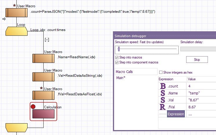

Posts: 1944
Has thanked: 508 times
Been thanked: 690 times
Re: Best tactic to decode JSON data..
That's great glad it's working better for you now :D Thanks for letting us know.
Just checked the component source and ReadDataAsFloat seems to be working ok for me. What chip type are you using and I'll test again on there just to check it's not a specific CAL/toolchain issue.
