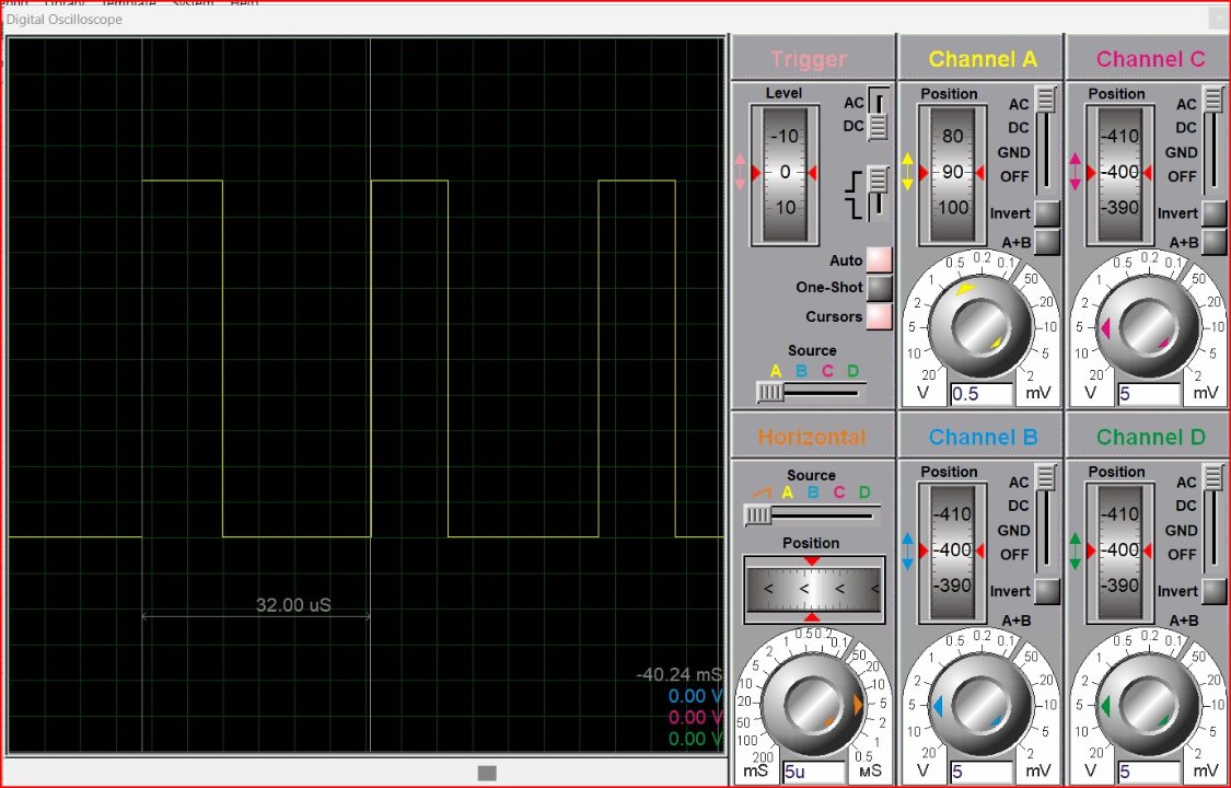

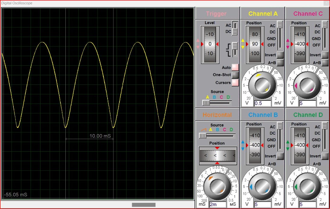

Re: Arduino interrupt Frequency
Thanks Mr. Viktor,
with help of Mr. Martin i got good 10mS long Sine half cycle after filtering the PWM as i expected,
my problem is to control the duration of the PWM . i would like to make it 50uS instead of 32uS.
please advice if there is any option.

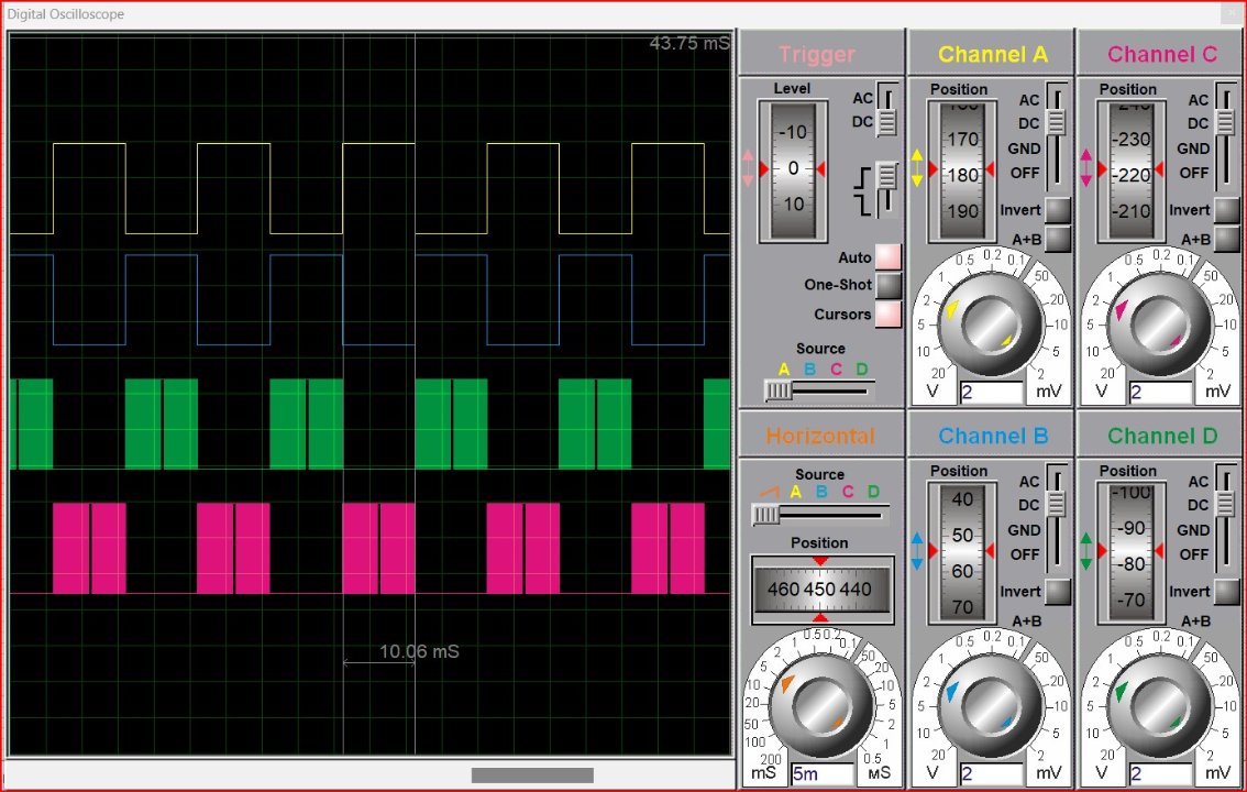

hi Viktor,
finally i managed to get the signals in proteus simulation as expected.
i am not sure how it behave in real hardware.
For your above question
I am not a professional doing its just as a hobby
at the movement i don't have any plan to test in real hardware.
