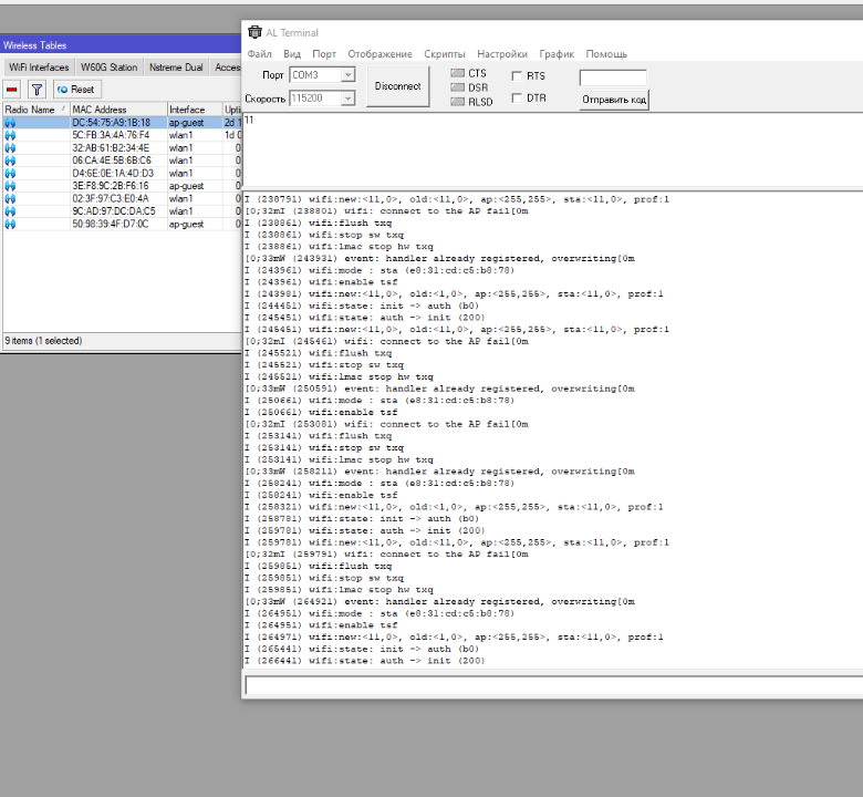

In general, in order to compile the program, I had to replace the ESP12 component with ESP32, the program compiled. But in hardware the ESP32 component is not working (even in Flovcode 9 it did not connect to Wifi, which remains in Flovcode 10). I tried to replace ESP32 with ESP12 and this also did not work due to the fact that both components are not working.
The program shows that I disabled the return of data on the initialization of the ESP32 component - the data is not returned.
I wonder if the developers somehow check the performance of their program? /Or is the main goal to sell the product and let users somehow improve it themselves? But how to improve without source code?
Versions 5 and 7 of Flowcode were still working relatively well, but then it started to get worse and worse.
I'm thinking more and more about switching to the Arduino platform.

I don't have much time at present, but a brief look through your chart above, the one in which you complain that the components don't work, show some concern. One of which is that you connect to a server but do allow any time for the server to respond before making a decision as to whether you have connected or not.
If I get a chance later in the week I will try and give you an example, but there are recent posts that illustrate the (very) basic steps to use an ESP32 to communicate with a server. You might want to look at those.
Hope this helps.
Hope this helps.

Travel delay so I have a bit of free time, but not much.
In your chart Flowcode1 you are using an ESP12S component but your actual target is an ESP32_WROOM_32 and wish to connect to a MQTT broker. How does it know what to connect to? I can't see any broker documented. I would expect problems when compiling to target with this chart.
In chart Flowcode1_net_ESP12 you are actually using an ESP32_WROOM_32. Your Network Component isn't linked to the ESP32 module though.
Again I do not see any broker documented so how does it know where to connect to?
If these modules are incapable of connecting to SSID/Host as you suggest then many, many issues would be reported. The fact that they are not, and a brief search through posts and the WiKi give examples of connecting to SSIDs, Servers and Brokers suggests that Flowcode does indeed work with these modules.
If you "right-click" on a component you will see a Help option that takes you to the WiKi, in which you will usually find examples and source codes.
Hope this helps.
