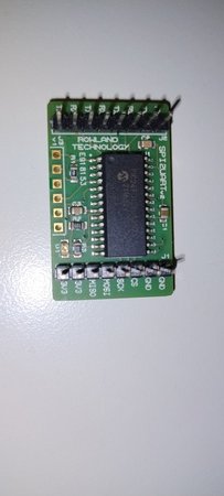

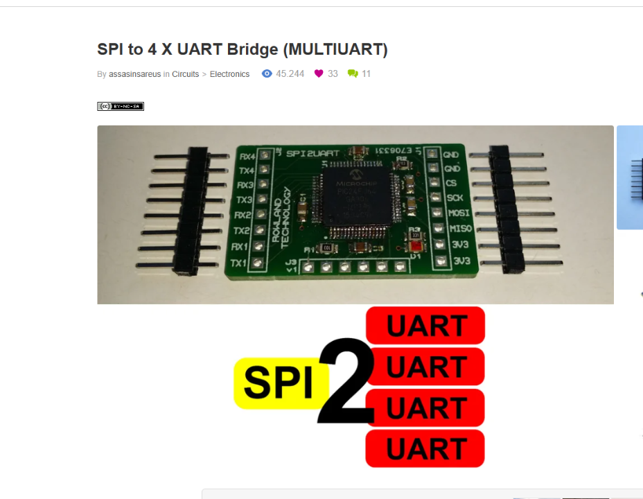

I wanted to ask you and in particular Benj if the Multiuart board that I bought some time ago and that now I would find useful to use, is the same one that he designed ( http://www.instructables.com/id/SPI-to- ... MULTIUART/) because seeing the one that I received it mounts a different PIC, if confirmed that it does the same things I would like to know if it can be used with FC9 and FC10 with the MULTIUART component block, and finally if the description on the web page remains valid for setting and use, and is the firmware already loaded?
thanks

Many thanks for posting and yes I can confirm there are two versions of the board, one with a square chip (v1) which was awful for me to solder and a newer rectangular chip (v2) which is significantly easier. Both are functionally identical and should both work with the Flowcode component. Firmware comes pre-loaded on the device.
