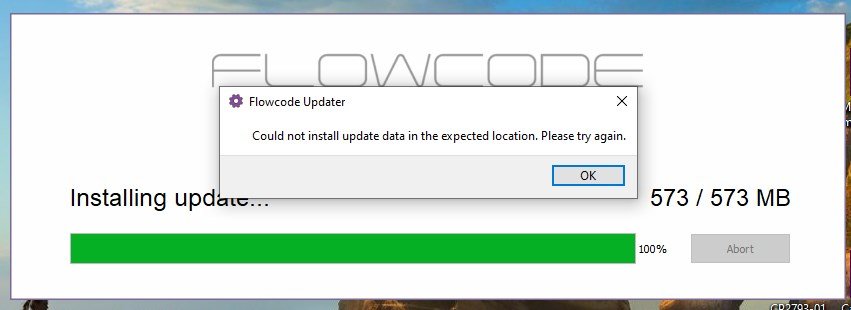

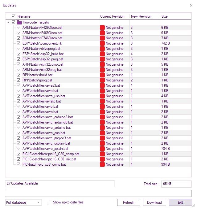

I tried to update my current version of FC v9 today. I could see from the update list that there were 27 updates but, for some reason it stated the files needing updating were not genuine. I tried several times to perform the update to no avail. I have attached some error messages which I hope will help. This is the first time I have had this problem as I have updated quite a few times previously without any issues. ( I am an administrator on my laptop. ) Regards Mark.

The first error message "Could not install update in the expected location" indicates that the Flowcode installer cannot replace the "data" folder of Flowcode. This is under the original installation location. It could be a permissions issue, or could be because Windows is holding one of the files open. Or perhaps another instance of Flowcode is running.
To fix this, I suggest you restart your PC and then run the Flowcode launcher. If this fails to download and install Flowcode then we'll need to investigate further.
The second issue shows some local files as "not genuine". This is because you are still running v9.0 but those files are for v9.1 and the original release of Flowcode cannot determine their status. You should be able to ignore these for now while running v9.0. The messages will go away once you have updated to v9.1.

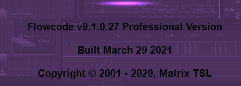

I think I managed to update, I suppose the new update is from 7.0 to 7.1 but where can I see my version please I try to look around in "help" )
Br Jorgen
EDIT. Found it. This migth be the latest version. What I do, run the update, restart the pc and create a new shortcut for the icon startup FC9, and this work for me and could maybe help my other friend´s here :lol:
