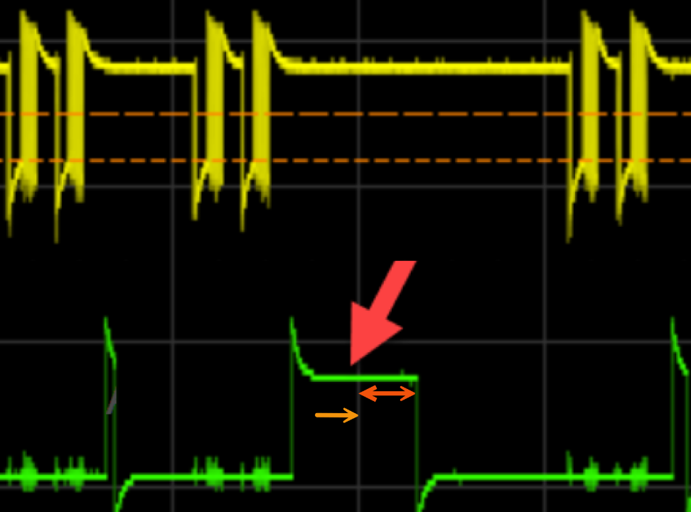

1. change to the next sector much faster
It would already help if this time was reduced by half. It's just a change to the next sector
reduce the "orange" time:

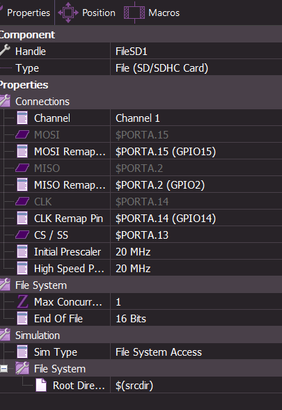

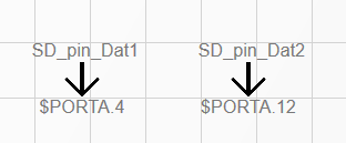

I made a second version of my programme. I have used the normal SD card component and am testing it now with this
I have replaced all commands.
i guess it is slow but i can maybe write sectoren with 512byte like by the PIC32
The pins are like this: config the Sd component: add 2 pins and set to high

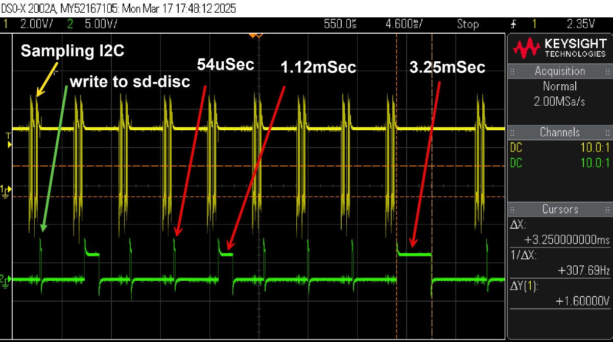

I looked at the writing on the disk again and noticed something even worse.
I always write the same amount of bytes to the disk. Once it takes 54uSec then after 2-3 times it takes 1.12mSec and then also once 3.25mSec.
So 60 times longer. This always happens at regular intervals.
These 3.25mSec rarely but regularly.
It prevents me from being able to sample and save easily with 480Hz (2.08mSec)
Osciloscope I measured the other values separately in order to have the exact duration.

Re: ESP32 4Bit SD-Mode Init problem
I will prepare a program to post.
I always append a string with length 147Byte and that works perfectly.
Hour-long recordings succeed.
Writing (append) a string 147Byte without changing sector or cluster takes only 54uSec (2.7Mbyte per Second?)
Writing with changing sector or cluster takes 3.25mSec (45Kbyte per Second?)
Do you remember a few years ago my PIC32 with SD-Card?
I had some problems with the SD-Card speed and you reduced the time to change sector and cluster.
My goal is to sample at 480hz and save to csv. I am making another device that samples at 8Khz and generates wave files
Actual result of recording with 120Samplerate on ESP32 are perfect!
