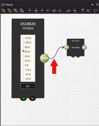

First you need to Link the DS18B20 component to the One Wire component as below:

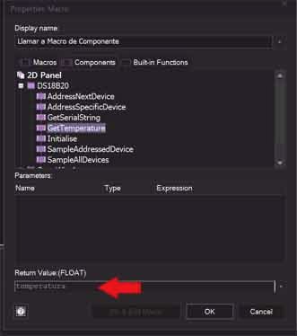

Next add your variable 'Temperatura' to the Return Value :(Float) under DS18B20 Component properties:
