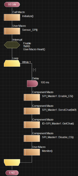

I want to read data from PIC24FJ512GA606 and IIS3DWB via SPI communication.
The manual says that if I write 0x12 0x01 0x10 0x05 0x0F in order, the value 0x7B should be returned.
When reading data from the sensor, it says that I should give the value of (Sensor Address | 0x08).
However, in the logic analyzer, only the value 0xFF is read without any change.
What is wrong with my project?

Hi Seokgi
0x12 0x01 is reset
0x10 0x05 is turn on
0x0F is read who i am
Just do this one time
and after send 0x0F add a read byte
You can use SPI not in softwaremode
Mod program:

tried to run the project you helped me with, but it doesn't work.
And when I use hardware channels, the clock and MISO, CS don't work.
Is there another way?

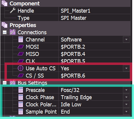

Can you measure a clock signal on the B5 with this program?
Can you also measure a few signals on the Mosi signal?
If so, try to change the clockphase, clockpolar, samplepoint.
Also switch off the USE Auto CS
Sensor_SPI_no_int.fcfx

CS signal is not generated and Logger does not recognize it as SPI.
I tried changing other options
