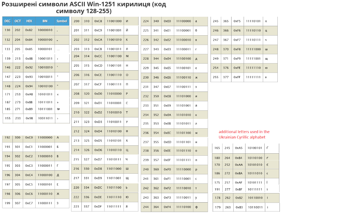

I have a tablet like this for the Ukrainian Cyrillic alphabet, partially selecting only Ukrainian letters from the Cyrillic alphabet and pulling them out of the general table in pieces. You can leave out the sign symbols and only add letters, if possible. Thank you very much.
Viktor
Viktor

With the Cyrillic characters - the easiest approach is to just increase the size of the lookup table - then just pass the relevant values in the string. This should work as is - at the expense of flash space.
I can't now remember which orientation the character's data needs to be in (top->bottom or vice versa) - but if you want to do 'one' with an obvious 'right way' up - I'll experiment.
If I get time - I'll try DrawTextCol too....
