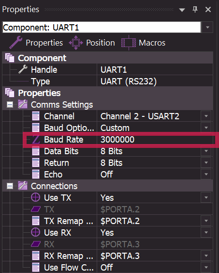

On my STM32F469 I can not use 3Mhz for baudrate, just 2Mhz is working
In Your programm:

I'm presently using the STM32F411CE to reliably drive a proprietary FTDI 232-3V3 USB-UART cable at 3Mbps, with all internal MCU bus clocks set to maximum permissible speed per STM32CubeMx application. This is required to support fast data reporting in real-time from SAR ADCs interfaced with a 3MHz SPI clock and 16-bit transacted data.
I overcame the weird RXINT2 anomaly by restructuring my code somewhat. Bizarrely, sending UART data (from MCU to host) soon after enabling RXINT2 originally highlighted an issue, but whether or not it had a negative bearing appeared to be dependent on the remaining code structure - very odd! Could well be compiler weirdness I suppose.
The project has grown quite substantially since such time, and still RXINT continues to perform without a hitch at 3Mbps (bidirectional data, no flow control), though once I've more time I will endeavour to strip out whatever may be construed as company-confidential information from the earlier problem project and make the modified source available to PM, if Flowcode support were interested.
