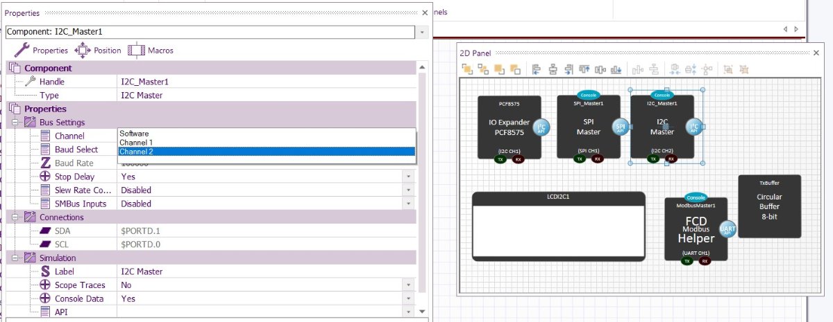

Please see below. In the I2C component you have the option to set Channel 1 / Channel 2 / Software.
Screenshot 2025-04-11 215637.jpg (108.9 KiB) Viewed 4005 times
Hope this helps.

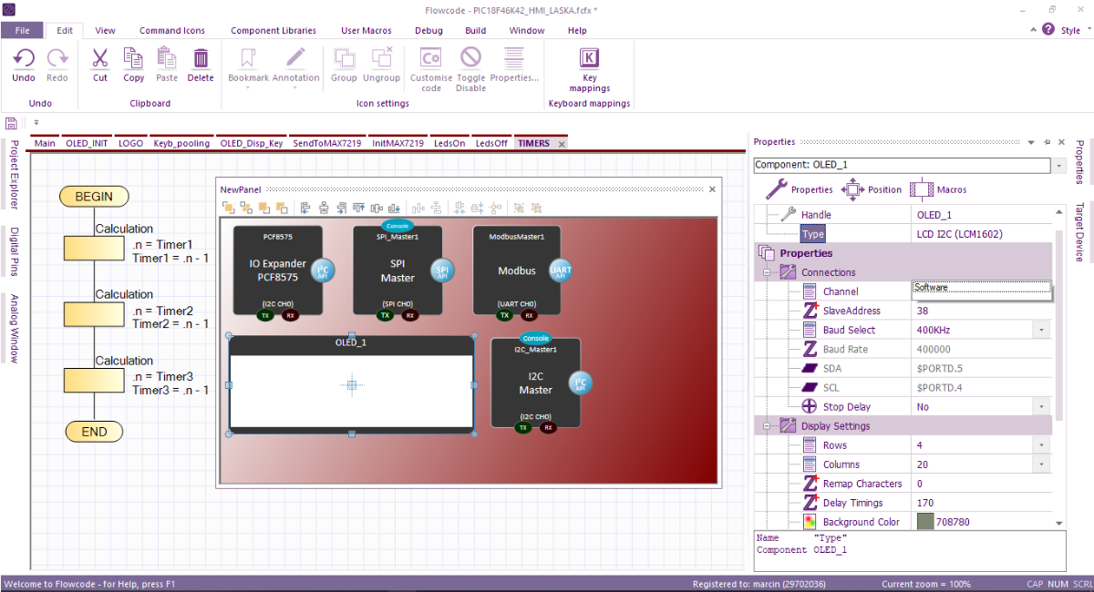

Thank you for your answer. Please look at the screenshot in my project. After expanding the selection window I have only the "Software" option and no other. As you can see in the project there is also an I2C LCD display with a PCF8574 expander and another I2C expander for supporting the PCF8575 matrix keyboard. In the properties of both components I also do not have the option to select hardware I2C.
Flowcode i2c.png (273.08 KiB) Viewed 3973 times
Flowcode i2c_1.png (275.1 KiB) Viewed 3973 times
Flowcode i2c_2.png (278.76 KiB) Viewed 3973 times
I even tried to reinstall Flowcode and update the microcontroller and component database, but it did not change anything.
For other microcontrollers, the options for selecting hardware I2C were there, so please help.
Best regards, Marcin

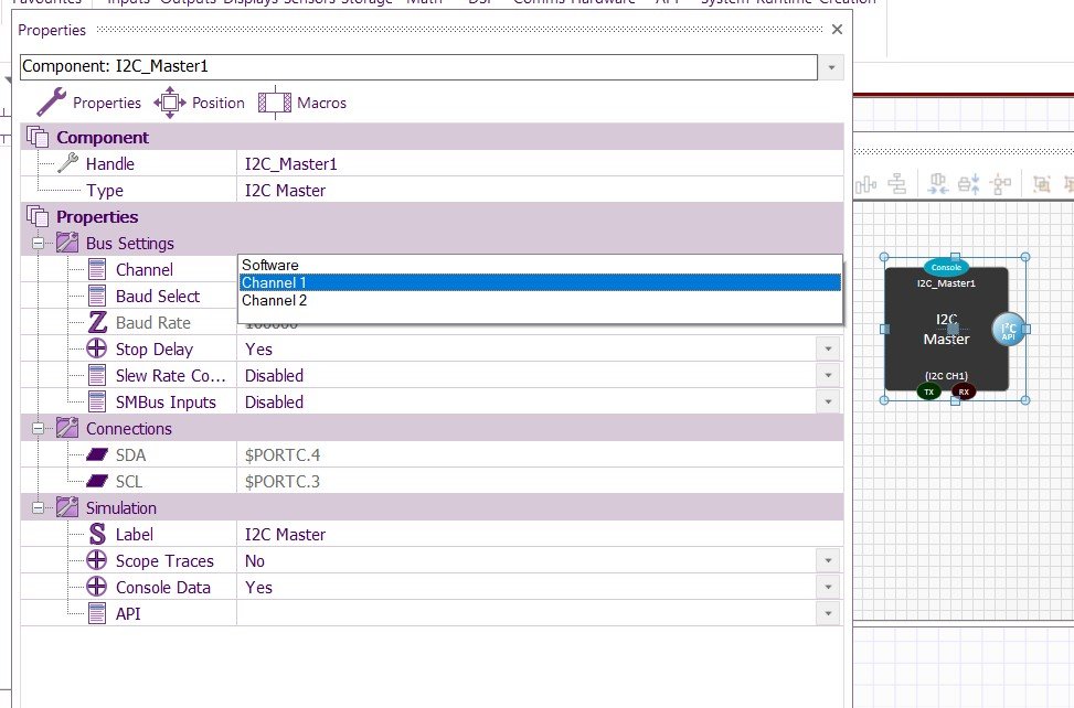

I have included all your components in a chart and all provide the channel options as shown in the example below.
Screenshot 2025-04-12 105935.jpg (107.37 KiB) Viewed 3927 times
Are you sure you are using the latest version (Flowcode 10.1.2.40) with full database update (Help > Library Updates > Full Database)?

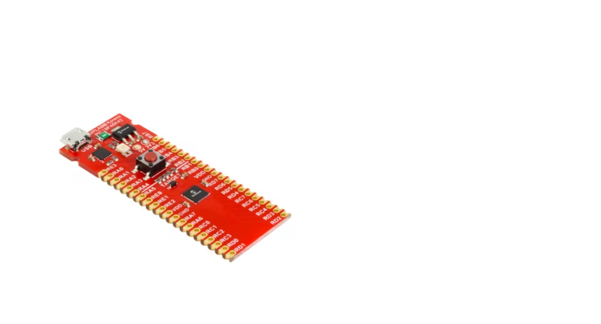

I agree with you. I did the tests on a small PIC16F685 microcontroller and they were successful, but the amount of memory was not enough, so I bought two boards that were available to me. One with a PIC16F15376 microcontroller and the other with a PIC18F46K42.
Xpress Board PIC18F46K42.png (171.66 KiB) Viewed 3380 times
Now I have to look for a board with another microcontroller compatible with the pinouts for the previous boards, hardware interfaces I2C, SPI, UART and a fast clock.
