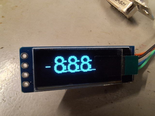

I'm getting odd artifacts when displaying a static Value. I created some FC to write circles over the whole area, this worked fine. So I'm assuming my i2C and Dispaly Hardware are OK.
20250515_130720 (Medium) (Small).jpg (111.57 KiB) Viewed 7970 times

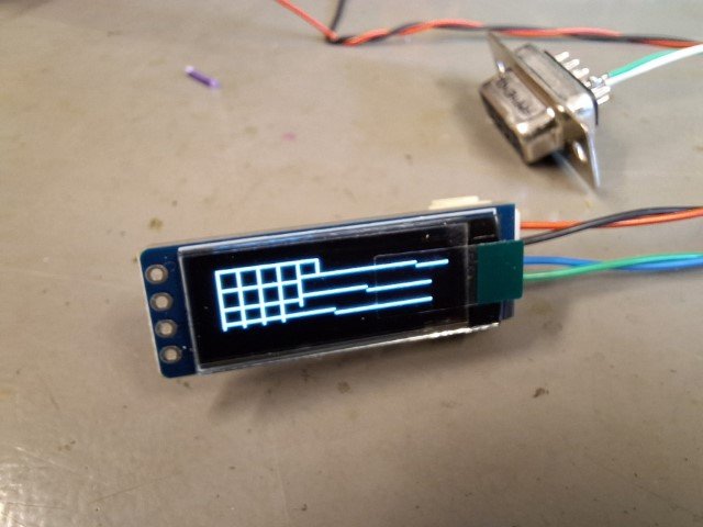

but I get odd artifacts with the rectangle component,
20250515_132209 (Medium) (Small).jpg (113.59 KiB) Viewed 7970 times
Staic NUmbers are not great,
20250515_162224 (Medium) (Small).jpg (120.41 KiB) Viewed 7970 times
If I make the value count I get even more artifacts.
It must be something to do with buffers etc but that is somewhat beyond me. :)
Any ideas on a relatively simple solution?

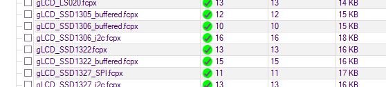

Hello there was an issue with this display.
There was an update to fix the issue you are seeing especially with the numbers.
If you open your project with the display, and select Help > library updates, does the display require updating?
The latest revision is 16. If you can't see the display you can select Show up-to-date files
If you have updated the library, you will need to reload your project for the updates to take effect.
If that does not work for you, then can you follow the instructions posted here.

Thanks Martin,
My component "gLCD_SSD1306_i2C" is version 16 and is shown as current.
Everything else shown is up to date.
FC V10.1.2.4
Using a PIC18F2585, tried with both hardware and software i2C.
I'll have a look at the roll-back. J.
