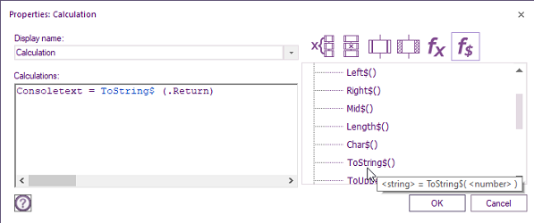

Hi, Steve.
Flowcode has it own built in functions you can access via fx or f$ icon.
That is showing you have misspelt ToString$ as ToStr$:

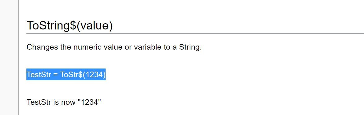

the wiki as a tad confusing / i have misunderstood - this is where i got that command from
https://www.flowcode.co.uk/wiki/index.p ... 28value.29
Working Now
Steve

Hi, Steve.
Yes, I agree the Wiki was confusing.
I have corrected it now.
Wiki ToString$.png (19.59 KiB) Viewed 3829 times
You can double-click or drag the function, so It is added for you in the calculation box.
