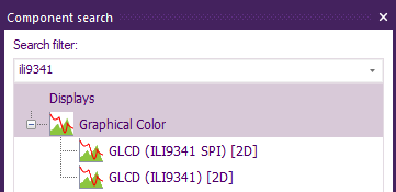

There are two ILI9341's to choose from.
One is dedicated SPI, the other is not!
Have you selected the correct version? If you have added the wrong component by accident, select the ILI9341 display on the 2D panel right-click > Selection > Replace...
Then choose the SPI version.
Saves being done manually.

If the component you want to replace with doesn’t appear in the Replace window, simply add it to the panel, delete it, and then use the Replace option again.
This lets Flowcode know which component you intend to use.
If the two components aren't compatible, Replace won’t work.
