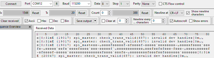

I can compile, but when I send measured values to uart, I get an invalid device handle from SPI instead of measured values.
from my terminal program:

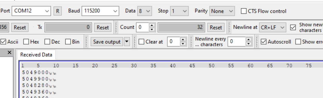

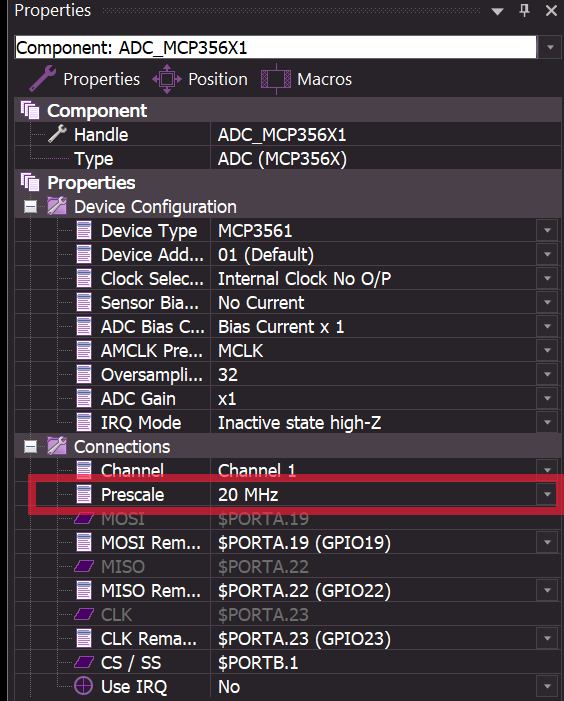

It's working now.
First I tested in software mode SPI and it was ok.
Then I reduced the prescale from 40Mhz to 20Mhz like in the pdf from the MCP35x1 and now the value are ok and no messages
reduced:
result:
