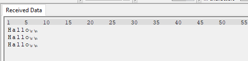

It send "hallo" to the uart and it'working nice.

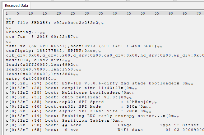

If I add and Init SK6812RGBW it's send boot....
Hallo ok:
With Init SK6812RGBW send to uart non stop:

Is there an error message it's giving you? i.e. just before the text you sent there? I've looked at the component code and it seems to be ok but I could be missing something. What version of the ESP32 IDF compiler are you using?

On computer 1 it's reboot
On compterr 2 sending "hallo" is ok
but led is dark (I also added set led and refresh.)
