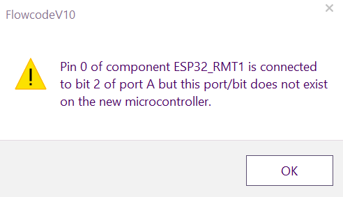

Screenshot 2025-08-28 211529.png (234.28 KiB) Viewed 5991 times
If you want to troubleshoot together, I can make an MS Teams or TeamViewer session with you. The same, if a Matrix TSL employee wants to dig deeper into this issue - I am available to look together at my setup.

Why wasn't it working? I've had to purchase the Arduino chip pack license and pick the Arduino Nano 328 115200 instead of the Arduino Nano 328. Since I did not own the license for the Arduino Nano 328 115200, I bought one and now my setup is working without problems.
The programming of my Arduino Uno works with both baud rates of 57600 and 115200 without problems.
Still, I encounter a strange error when toggling between these two chips, which relates to the ESP32. I think this is a bug which needs to be reported, or?
Screenshot 2025-08-29 161344.png (13.66 KiB) Viewed 5897 times
