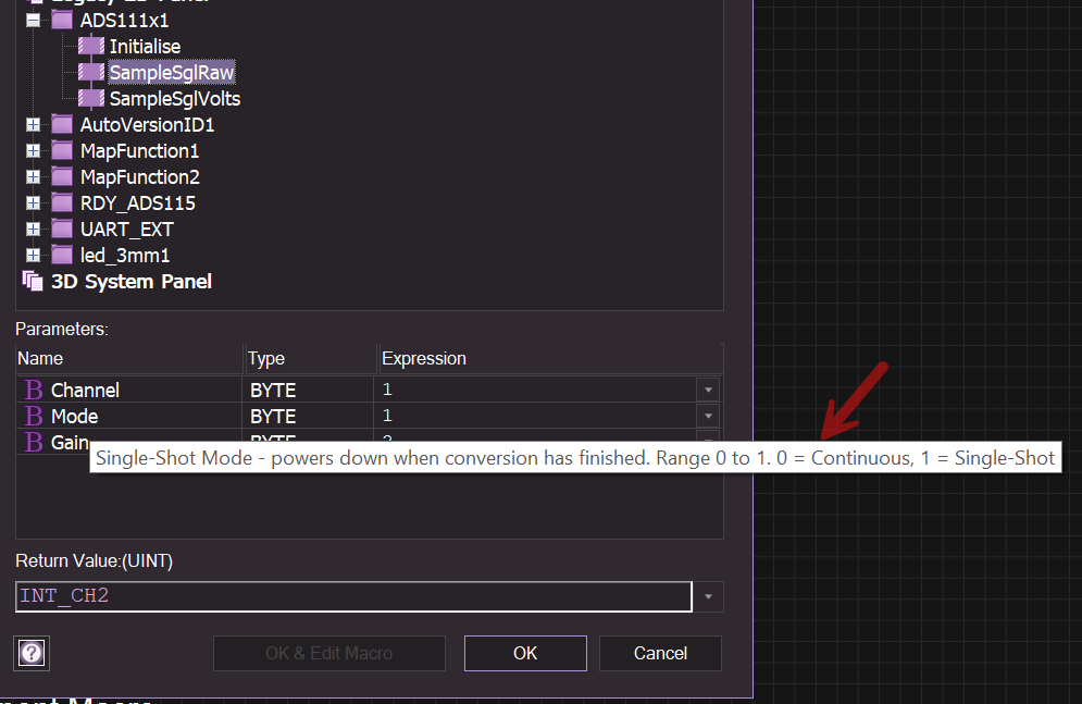

I'm testing the ADS1115 component and I've noticed some strange behavior. Basically, in the code, if I select only channel A0 on the UART output, which I read with a serial program, I read the correct value as ch1. The same thing happens if I select only A1, excluding A0 from the program, I correctly read the value as ch2. However, if I activate both channels, the value I should read on ch1 (A0) is seen on ch2, and the value of ch2 (A1) is seen on ch1, as if the two channels ch1 and ch2 were reversed. I also wanted to ask how the ALERT/RDY pin is set, and if it isn't, how to set it as RDY and how to handle it correctly.

1.Can you try out change ADS1115 to read Continus mode?

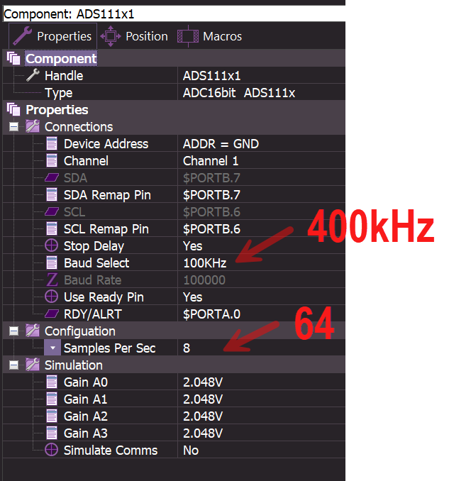

2.Set I2C clock to 400kHz and Samples per second to 64 (later back to 8 or 16)
3.Test the IRQ from the STM32F411 if it is 0.25Hz

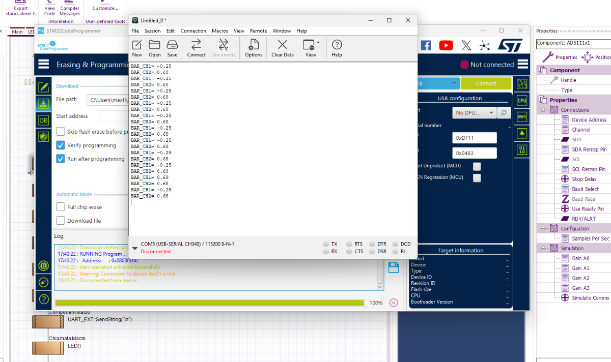

I tried your suggestions. I reset it to 400kHz, sampled at 64, then went down to 16 and 8. I increased the baud rate to the maximum, set it to continuous mode, and I actually initially set the IRQ rollover value to 15600 to get 1 second. I don't know why it reverted to 65536.
The values ​​for ch1 and ch2 remain reversed. ch1 should read 0.68 and ch2 -0.25 since nothing is connected to it.
