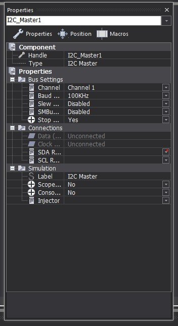

Hi Guys I'm having a problem with the I2C component in V7 as it wont let me select the SDA and SCL pins when i click on the dropdown menus it is blank how can i sort this out? as i deleted flowcode downloaded it again reloaded it still the same thing is happening
Posts: 2241
Has thanked: 616 times
Been thanked: 814 times
Re: I2C component faulty
What chip are you using? Can you attached your project file?
I've just tried the 16F18877 in v7 and it appears to be working correctly there.
Would using a software channel or upgrading to v10 be an option?

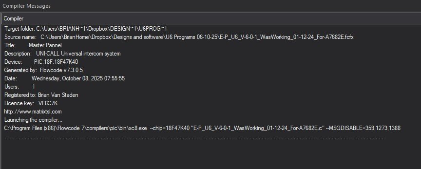

Another thing is if i try to program the chip from my new PC the compiler hangs. I thought that the compiler was corrupt so i copied from old machine into new machine still no luck. I Have done a windows 11 repair as i thought something might be corrupt with windows then i removed V7 and reloaded it still no luck not sure where to go from here now
Compiler message.jpg (38.56 KiB) Viewed 6649 times

This is driving me crazy i tried to program a board today and the compiler was just hanging as above so i deleted flowcode V7 reinstalled now it has stopped the hanging but now sending me this error.
Target folder: C:\Users\BRIANH~1\Dropbox\DESIGN~1\U6PROG~1
Source name: C:\Users\BrianHome\Dropbox\Designs and software\U6 Programs 06-10-25\E-P_U6_V-4-6-2_WorkingON_11-11-25_For-A7682E.fcfx
Title: Master Pannel
Description: UNI-CALL Universal intercom syatem
Device: PIC.18F.18F47K40
Generated by: Flowcode v7.3.0.5
Date: Tuesday, November 18, 2025 14:12:53
Users: 1
Registered to: Brian Van Staden
Licence key: VF6C7K
http://www.matrixtsl.com
Launching the compiler...
C:\Program Files (x86)\Flowcode 7\compilers\pic\bin\xc8.exe --chip=18F47K40 "E-P_U6_V-4-6-2_WorkingON_11-11-25_For-A7682E.c" --MSGDISABLE=359,1273,1388
Microchip MPLAB XC8 C Compiler (Free Mode) V1.41
Build date: Jan 24 2017
Part Support Version: 1.41
Copyright (C) 2017 Microchip Technology Inc.
License type: Node Configuration
E-P_U6_V-4-6-2_WorkingON_11-11-25_For-A7682E.c:
27573: #warning "This interrupt has previously been enabled, so the macro <Getkey> may never get called."
^ (162) #warning: "This interrupt has previously been enabled, so the macro <Getkey> may never get called." (warning)
27586: #warning "This interrupt has previously been enabled, so the macro <Getkey> may never get called."
27599: #warning "This interrupt has previously been enabled, so the macro <Getkey> may never get called."
27625: #warning "This interrupt has previously been enabled, so the macro <Getkey> may never get called."
27662: #warning "This interrupt has previously been enabled, so the macro <Getkey> may never get called."
27675: #warning "This interrupt has previously been enabled, so the macro <recive_data> may never get called."
^ (162) #warning: "This interrupt has previously been enabled, so the macro <recive_data> may never get called." (warning)
27687: #warning "This interrupt has previously been enabled, so the macro <Getkey> may never get called."
27700: #warning "This interrupt has previously been enabled, so the macro <Getkey> may never get called."
27713: #warning "This interrupt has previously been enabled, so the macro <Getkey> may never get called."
27726: #warning "This interrupt has previously been enabled, so the macro <Getkey> may never get called."
27739: #warning "This interrupt has previously been enabled, so the macro <Getkey> may never get called."
27752: #warning "This interrupt has previously been enabled, so the macro <Getkey> may never get called."
27765: #warning "This interrupt has previously been enabled, so the macro <Getkey> may never get called."
27778: #warning "This interrupt has previously been enabled, so the macro <Getkey> may never get called."
27791: #warning "This interrupt has previously been enabled, so the macro <Getkey> may never get called."
27804: #warning "This interrupt has previously been enabled, so the macro <Getkey> may never get called."
27817: #warning "This interrupt has previously been enabled, so the macro <Getkey> may never get called."
27830: #warning "This interrupt has previously been enabled, so the macro <Getkey> may never get called."
27843: #warning "This interrupt has previously been enabled, so the macro <Getkey> may never get called."
27856: #warning "This interrupt has previously been enabled, so the macro <Getkey> may never get called."
27869: #warning "This interrupt has previously been enabled, so the macro <Getkey> may never get called."
C:\Program Files (x86)\Flowcode 7\CAL\PIC\PIC_CAL_I2C.c: FC_CAL_I2C_Master_Init_1()
246: = 0;
^ (195) expression syntax
247: = ;
248: = ;
276: tris |= (1 << (0));
^ (192) undefined identifier "tris"
C:\Program Files (x86)\Flowcode 7\CAL\PIC\PIC_CAL_I2C.c: FC_CAL_I2C_Slave_Init_1()
535: = 0;
536: = ;
537: = 19;
E-P_U6_V-4-6-2_WorkingON_11-11-25_For-A7682E.c: main()
13342: break;
^ (345) unreachable code (warning)
27541: }
^ (350) unused label "FCC_Main_V" (from line 0) (warning)
(908) exit status = 1
C:\Program Files (x86)\Flowcode 7\compilers\pic\bin\xc8.exe reported error code 1
FINISHED
Please can someone help as i need to install a system tomorrow and i found a small software error which i have corrected but need to program to the board
(905.22 KiB) Downloaded 178 times
Posts: 2241
It appears the SDA Remap pin of the I2C Master component is unassigned in the project.
