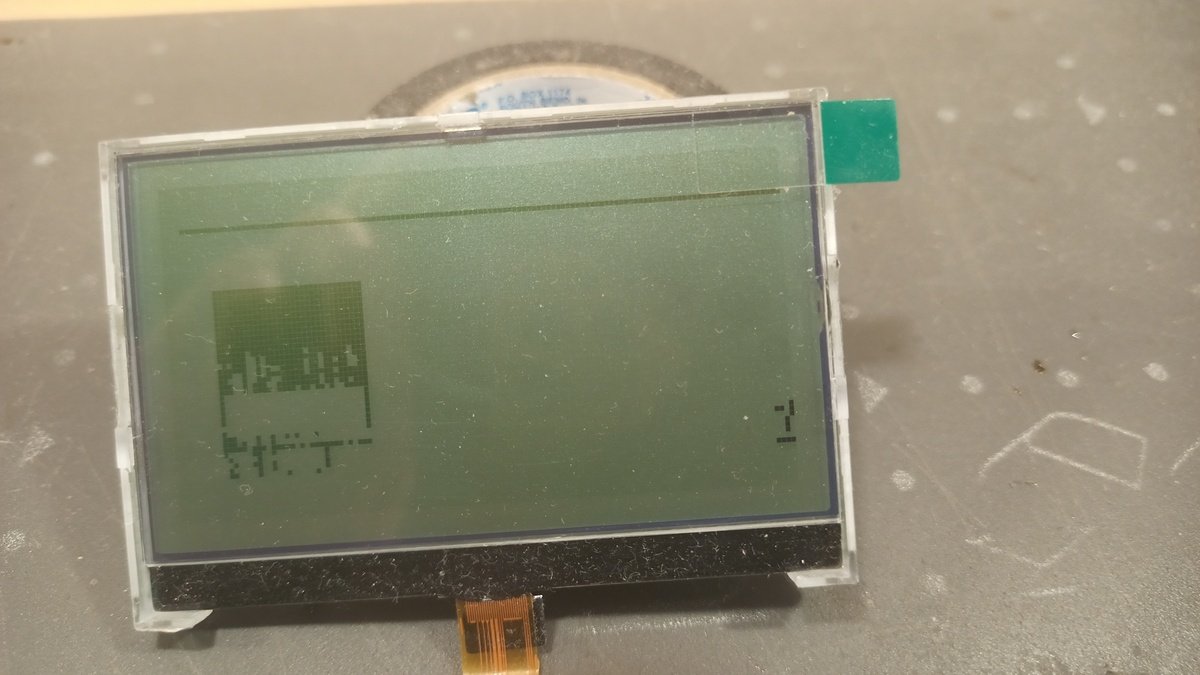

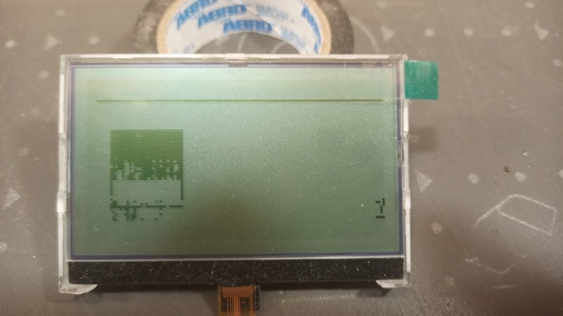

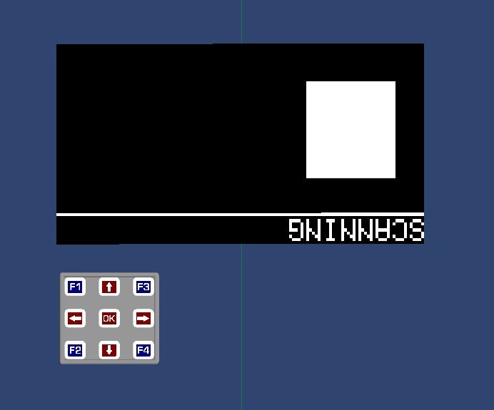

Everything works in the compiler.
Not on the real device.
What am I doing wrong?
PIC18F67K22
MDFC9.fcfx
program
(38.03 KiB) Downloaded 420 times
In the device
In the device
In the compiler
In the compiler

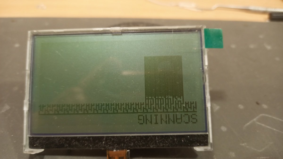

Hello!
I compared there are changes.
I'll send you a picture now
New
New
New HEX.jpg (97.42 KiB) Viewed 7580 times

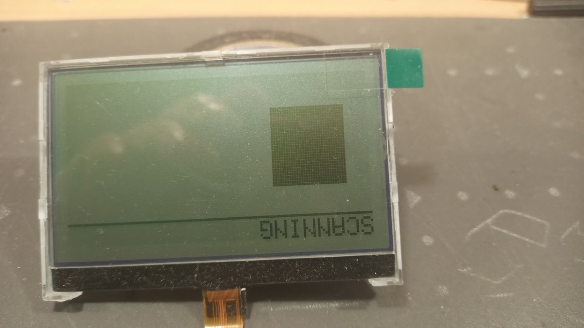

Post by Osta »
It's all back again...
Does your HEX work..
New lib
New lib
New lib.jpg (121.35 KiB) Viewed 7547 times
