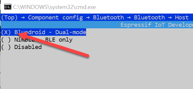

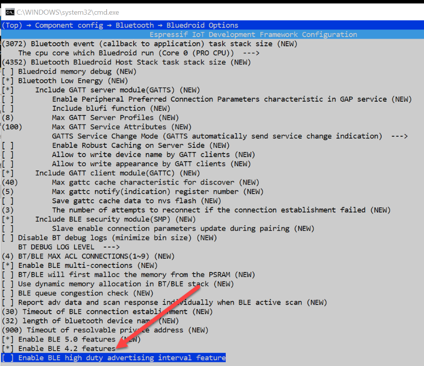

Right the ESP32 BT BLE Server is now fully functional and live on the library updates. Let me know if you have a go with it. I've done fairly thorough testing and for me it's very responsive and working great.
Note if I try and pair a device directly in Windows or on my Phone it fails. But if I don't pair and instead connect to it directly from a serial BLE app it's connecting and working as it should.
Another thing to note is in the menuconfig under Component Config -> Bluetooth. You must make sure Bluetooth is enabled, Host is Bluedroid and in Bluedroid options ensure that Enable BLE 4.2 features is checked.

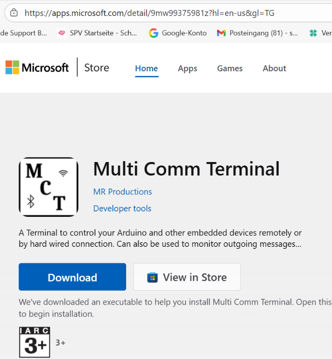

On the Notebook and a phone It' found the FC11 BLE SPP
On Computer and IPhone It was not found.
I installed a APP on the Computer but id did not found
I will test it some more.
config:
Multi Comm Terminal
Posts: 1300
Has thanked: 246 times
Been thanked: 258 times
Re: FC11 ESP32-S3 BLE error
I installed the Multi comm terminal on another computer,
and there I can receive the sent string from ESP32-S3 and BLE.

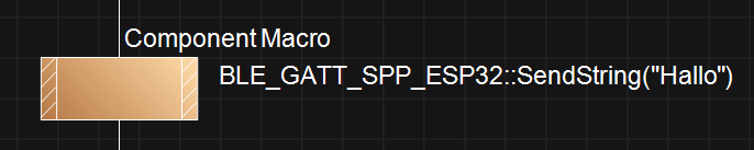

I tested it for Android and iPhone, and I can receive the string with an App.
My wish is to be able to send an integer array and receive it in the App developer, just like with UART or classic Bluetooth.
My test with a string was working nice.
ESP32 send:
received App for Iphone:
received App for Androide:
