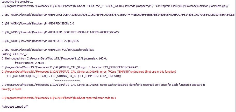

I have just tried to compile a program that compiles in FC10.
It may be that I have not installed the toolchain as it is already on the PC as it has FC10 already on it. I have looked at the settings and cannot see any difference.

Have you done a full database update?
I've a feeling this has been fixed,
But I'm not currently in near my PC to check

Thanks for the suggestion, I have just done a full update of 337 items and it still does not compile.

Have a look at these posts ...
https://www.flowcode.co.uk/forums/viewtopic.php?t=3467
https://www.flowcode.co.uk/forums/viewt ... 794#p21794
Ben, can you update the CAL file please, and I suspect the file versions might be in error,
my V11 compiles this test project OK, but my CAL file is V1.0 and doesn't have the these extra new functions (that has the error)
and also my V11 doesn't update to this newer version (hence I suspect a CAL version issue) - hope that helps.

I did a compare of FC10 & FC11 RPI_CAL_String.c with Winmerge and they were different. FC10 was V1.0 and FC11 was V3.0
I renamed V3.0 and copied V1.0 from FC10 and it now compiles to hex (not tried to compile to target yet.
The weird thing is when I do an update I was expecting to see the version difference but it does not show any so was V3.0 withdrawn but not removed from the download?
