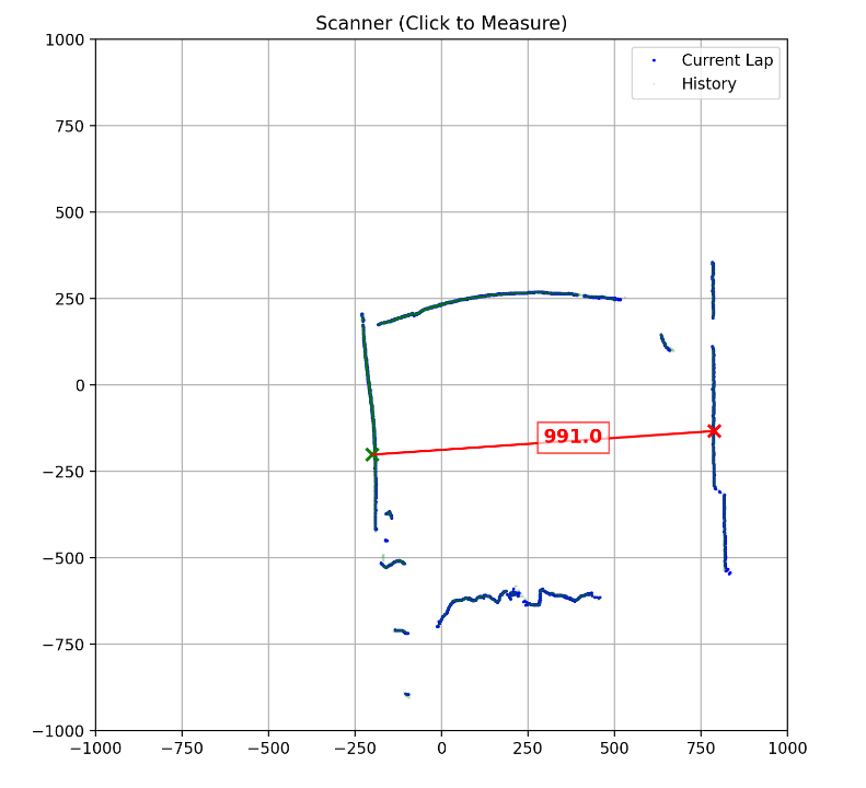

I got a G4 LiDAR sensor - (from YDLiDAR) - and connected it to a PSU and an esp32. The eventual aim is to have the esp32 display the output (or save to SD?) - but for now it outputs the data to a PC (as X,Y pairs) - where it is displayed by a Python app.

Process data - calculates the start and end angle (and the difference between them (/ points -1) - as individual steps) - and then calculates x, y data using polar co-ordinates (x = d * cos(angle) y = d * sin(angle)
There was originally an option to output data in 'readable' form as '(x,y)' - but for speed the binary format is better - I buffer the data then output it using WriteIntArray. The final data might have a different number of points - as I check if distance is 0 (it might be better to check > min_distance?) - so the final output format is 0xAA55 NNNN XXXXYYYY XXXXYYY - where NNNN is a 16 bit number of XXXXYYYY values.
This is output (in the attached for alternate 'laps' - n_laps constant) - to UART1 which I have set to 921600 baud - if your PC can cope - if not reduce this! My PC can cope with every lap (I think?) - however if the process queue is filled then some data may be dropped.
After a bit of 'fiddling' - originally I had left and right / up and down swapped. - the output looks reasonable - and you can click on two points for a measurement between them.... Objects have a 'shadow' - so anything 'behind' an object is hidden.

A sample output - current 'lap' is in blue with previous fading in green.
I'm the fuzzy line at the bottom - my monitor (which is curved!) at the top.
