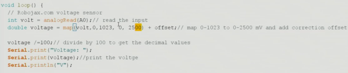

Minute 2:14 in this Youtube explanation.
https://www.youtube.com/watch?v=FaoKzi7tgME&t=280s

I found the modul:
And what is used in the modul:
There is a command "map" used in the software,
I guess that's the same as the map component in Flowcode.
I hope that helps a little.
I haven't used the map component yet, but I will be using it soon for my project.

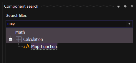

I am not seeing the MAP function in Version 11.

Hi Bill.
Within Components ribbon, make sure Show Components on the far left is set for 2D & 3D.
Then click on the magnifier next to Show Components and enter map.
The Map Function can also be found within Components > Math > Calculation.
