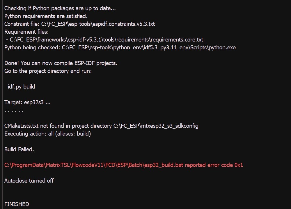

When trying to compile to Hex the following error code is reported.

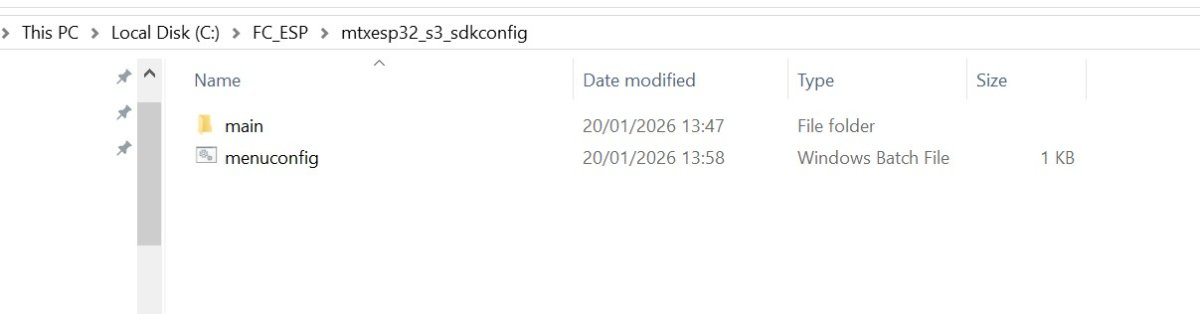

If I open the ‘mtxesp32_s3_sdkconfig’ folder there is no ‘CMakeLists.txt’ file.

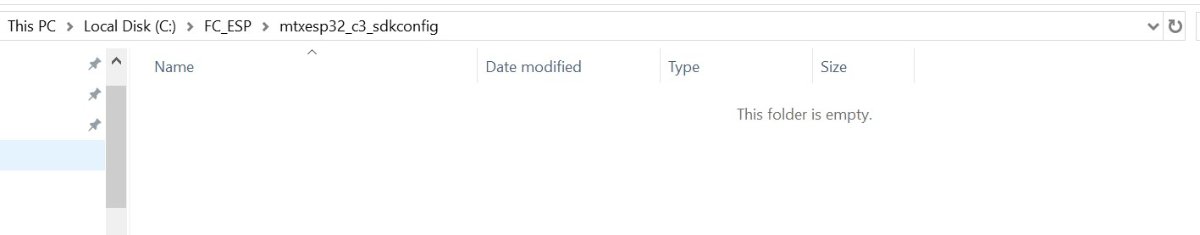

I note also that the other folders such ‘asmtxesp32_c3_sdkconfig’ within the FC_ESP folder are empty.
Are these folders populated when the ESP Tool chain is installed or are they populated during the first successful compilation process?

Attached is the 1Hz Flasher program and the complete compiler error message text.

Those folders are populated when a compilation takes place.

Comparing the msg.txt file, yours has 4 "The system cannot find the file specified" errors near the start after the "Building: 1Hz flash ..." line. This might be related to the following lines in the "esp32_build.bat" file:
You can find this file in the C:\ProgramData\MatrixTSL\FlowcodeV11\FCD\ESP\Batch\ folder and you could try adding some debug messages (e.g. "echo my_message") just before and after these lines to see if those are the lines causing the issue.
If they are, then the previous line "@PUSHD %~dp0" might be setting the current folder wrong. Although I don't know why this should be the case. The command "echo %cd%" shows the current folder (add it just after the 4 lines above and it should print "C:\ProgramData\MatrixTSL\FlowcodeV11\FCD\ESP\Batch" in the msg.txt output).

Following Steve's instructions and adding the debug messages it does appear to be those four lines causing the issue. Adding "echo %cd%" does print "C:\ProgramData\MatrixTSL\FlowcodeV11\FCD\ESP\Batch" in the msg.txt output, so it is pointing to the correct folder.
