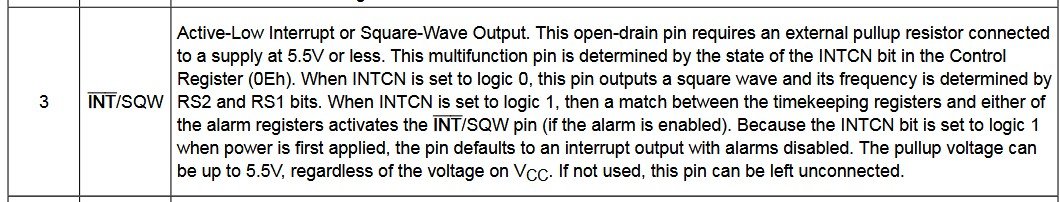

Are you having the uC "sleep" and the DS3231 is to wake it up at a set time? If so a C-code block would do that with the DS3231 Int pin connected to any IOC / Interrupt pin on the uC.
Or is your entire circuit "shutdown" including uC and you will repower at a set time?
From the datasheet
Screenshot 2026-01-29 043122.jpg (84.14 KiB) Viewed 2935 times
A logic-level FET would do that and they range in currents from mA to many Amps. You would need to "self hold" once triggered, possibly by using a pin on the uC to keep the FET triggered.

Thank you chipfryer27 for your reply, I am sorry if I was not clear. All I need is to enable the SQW output that matches the alarm when the module goes to battery backup, the battery on the module. I have set the module to go low at every minute with Flowcde already when on power. So all I need, like you said, would be a C-code block to enable the bit(s) in the registers to do just that. I am not very good a C code. I have an electronic background so the rest is easy.

To access that register you just need to send a command to the register using I2C from your microcontroller. Best to set the entire register to what you require all at once. Address is in hex 0E, and it is bit 2 (3rd bit) that needs to be set.
