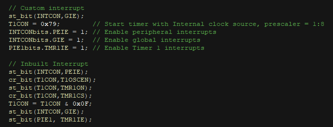

Ok, I understand. I suggest then you try using the inbuilt Timer 1 interrupt and look at the C code that is generated. For example, the following shows the custom code and the inbuilt code and from that you should be able to see how it works.
The datasheet for the chip should also have a lot of useful information about the settings required for T1CON.
