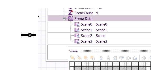

Hi!
When I use dsplaymanager I have 2 scene, scene0 and scene1, if add a new scene the name is scene, do I again add one more scene the name is now scene3?
I have tryed to rename the scene without luck, is this possible?
And let´s say I not want to use scene1 anymore how do I delete this without set the display count to one an start from the beginnig again?
Thank´s in advance
Jorgen

Hi Jorgen,
The display creator scenes can be renamed using the Panels tab of the project explorer pane. Just right click on the scene you wish to rename and type in the new name. This will automatically roll through to the Display Manager component property.
e.g. you could have scenes named Scene_Home, Scene_Menu, Scene_FanControl etc...
If you reduce the SceneCount property of the Display Manager then it will not delete any of the scenes from the project, it will just allow you to pick from the existing scenes. Any scenes that you do not want can be deleted again using the Panels tab of the project explorer pane.
