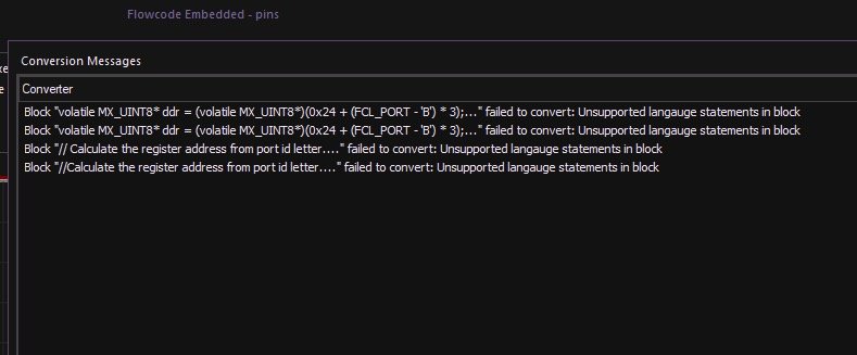

A small out of the context question.
I was trying to simulate ( C-Sim ON) Pins.fcfx in Flowcode V11, I am getting an error message. I am sure this code will work on Hardware.
I am attaching the error message screen shot. please suggest if there is anyway I can simulate this C Code.
Thanks for the code. It helps us in sharpening our C skills. Your are really good in C.

Re: Creating a string to be used in a digital output statement
Yes - sorry it won't simulate. Of it was useful it could be converted into a component, with separate implementation to do the simulation.
It is also specific to AVR MCUs - although it might be possible to do a similar thing on others (it relies on the port register's having a fixed interval between them)
