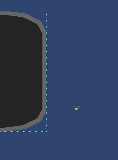

Evening All,
Don't know what i have done, or if i have missed it and it has always been like this. I am Fairley sure they where not like this before
They are very very small compared to other icons on the dashboard - how do i resize them ?
Steve
logo icon - next to modbus icon.JPG (13.93 KiB) Viewed 7509 times

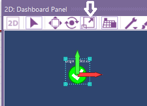

Or select Scale (White arrow) and drag one of the corners with the mouse.

Am i missing something ? the logo icon doesn't seam to resize ? i can resize the other icon on the dash board but not the logo ones? I get the box around it but it dosnt want to drag from the corners. so i can resize them
looking for " real world size and increase the size for x, and y." i cannot see this property in the properties box ?
Steve

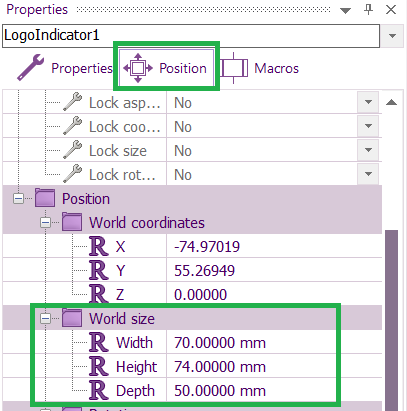

Hi, Steve.
Could it be your panel zoom is causing the issue?
If the component is too small then you may have issues dragging?
What is the Zoom level shown on the bottom right of the 2D Panel?
You can set the X Y size by right-clicking on the component, select Properties.
Select the Position Icon at the top of properties.
You can adjust the size in the Position, World Size options.
Resize Components.png (25.21 KiB) Viewed 7462 times
I would recommend using zoom level of 100%
Yuo can right-click on the panel and choose Zoom to 100%

Zoom was at 63 % - adjusted to 100%
Text Size was 1.000 changed this to the setting you have and all looks ok now.
