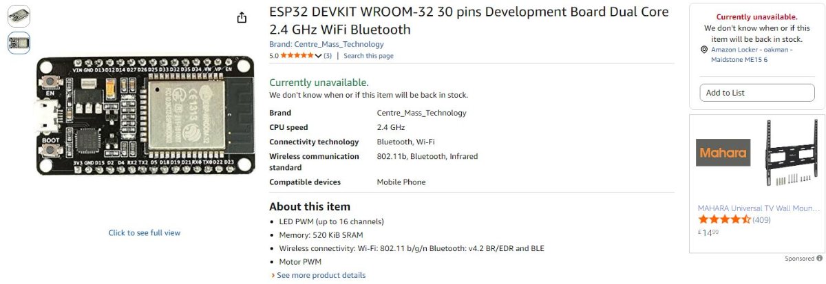

I have gone through my emails and this is the device I have got. I am reluctant to bin it even after all the grief it has caused me. Pretty much all I use these for is the WiFi and serial ports and I have had a brainwave.
I do not know if it will work but I am going to program TX1 and TX2 sending a repeated string such as This is TX0/1/2 and test each pin with a module set for the known BAUD rate to hopefully find the pins. The RX are normally adjacent.
I also have one from Kunkune that looks the same (when i can find it) so will see if that is normal
Bob

That looks very like the one i have... Like some PIC MCUs - most functions can be directed to (nearly) any pin. There are a few reserved(connected) to things like the wi-fi module - however generally if it is broken out to a pin you can use it.
The only 'fixed' pins are SPI if you need the highest speeds - and ADC and capacitive touch have a limited range too...
I think the tool chain (and indeed the device) are still relatively immature - and still changing rapidly - which causes a lot of issues...
