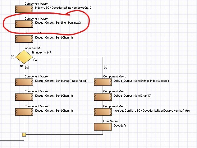

In my attempt it does not reboot the ESP32 but the data is always zero. The debug messages output on the web app shows what I think it the correct message. The issue seems to be in the ESP32 code, I have put lots of debug messages in to see where it is failing and that seems to be the Index has a value of -1 so it never gets to the decode macro.
This is what I see in the serial monitor, all seems to be what I would expect until the -1 as the "Decision" is looking for Index >= 0

This is where I think the issue is.

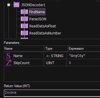

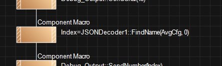

I think this is your problem. Its being passed a variable which is empty but this should be the string of the data tag your looking for.
Should instead look like this with quotation marks around the tag.

I do have an issue with this though (hopefully I don't sound ungrateful), I think FC should have picked this up as an error.
When I selected the variable it was from the dropdown list so FC knew it was a string being selected (and the type it was expecting should be a string) so it would be nice if the quote marks are added or an error shown if the quote marks are missing.

Flowcode cannot pick this up as an error. Passing a literal string "abc" will search for that name. Passing a variable will search for the *value* of that variable. There are legitimate times when you might want to pass a variable (for example, there may be multiple "Name0", Name1" , etc values you are trying to find and you can use a variable to create the string each time).
You passed a string variable, and so Flowcode (quite rightly) assumed you wanted to search for the value of that string variable (which, because you have not set it, is actually blank).
