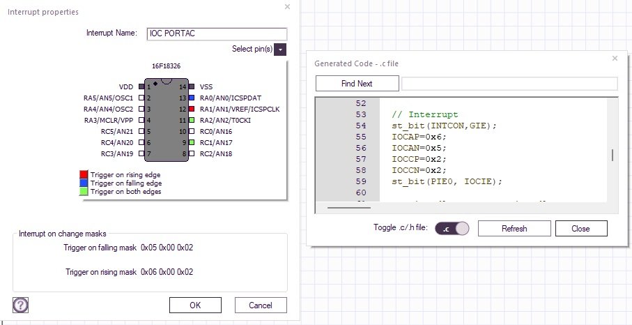

I added an IOC interrupt to a chart and selected some pins (the 'selection' image is too small - and I couldn't find keys to enlarge it) - then looking at the code generated:
  // Interrupt
  st_bit(INTCON,GIE);
  IOCAP=0x28;
  IOCAN=0x18;
  IOCCP=0x0;
  IOCCN=0x0;
  st_bit(PIE0, IOCIE);
Which looks okay?

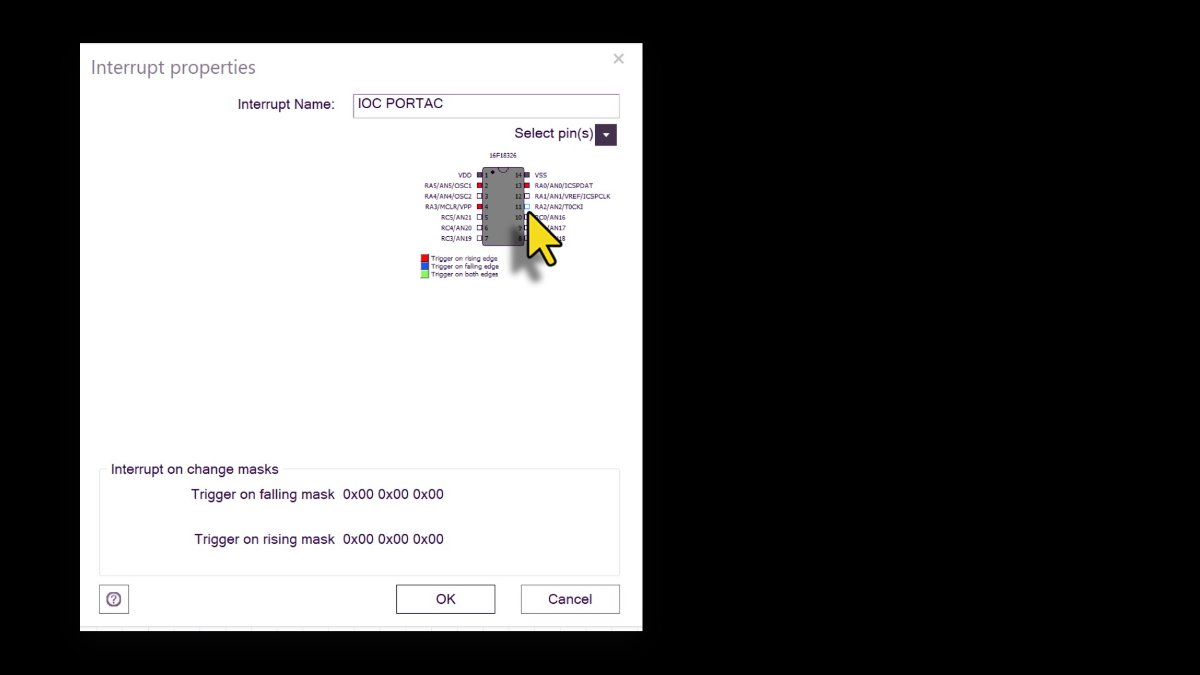

An issue with the 'interrupt' block handler - the pin diagram is to small and the masks don't change when selecting pins (although clicking the 'select' arrow again shows the values)

Port selection looks ok to me in v11.

I still have the odd layout - with the masks as 0 (until I minimise the select pin(s) diagram)
