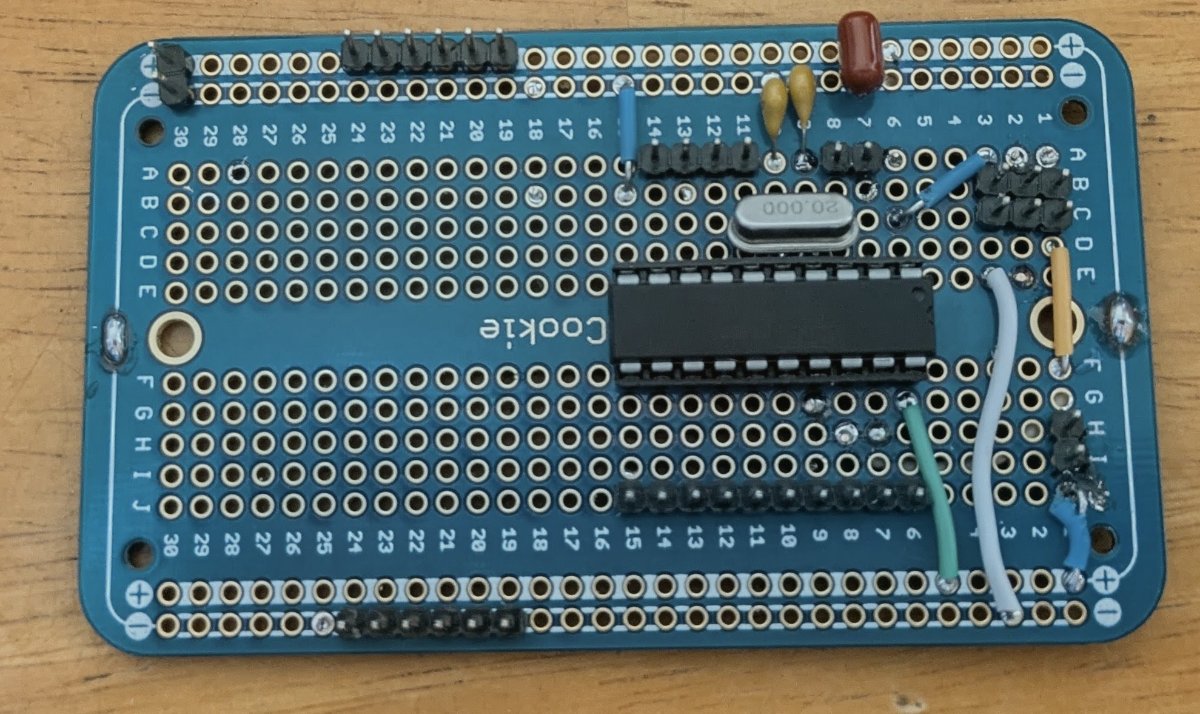

I made a small ATTiny4313 dev board. The MCI can run at up to 20MHz (or 8MHz internal)
I breadboarded and it worked well, although the connection to the programmer was a little 'delicate'
So using an ElectroCookie solderable breadboard i set to make a version with an ICSP header.
This entailed cutting three tracks - and i also added a jumper to allow external power. Originally i had a 10K pull up resistor to pin 1 (reset) bit I removed, when testing failed. It seems okay on the internal pull-up but might be good to re-add.

I had most difficulty soldering the header pins - some melting has occurred on my VCC jumper :-(
I hit two problems - it didn't work ( a biggy) - i checked the board carefully and I hadn't bridged the links in the power/ground rails..
Still no joy - and attaching a scope, I see that reset doesn't pull low. I removed the 10K resistor :-(
Programming the chip separately (I knew the socket was a good idea) convinced me that the MCU was running okay (blinkie) - so I checked the wiring again!
Then I noticed that I had plugged the programmer cable into the UDP port - doh..
I wrote a small batch file for Flowcode (I used a Diamex programmer) - and all works well....

... and I forgot to connect VCC to pin 20...
Which took rather longer to notice than you'd hope :-(
