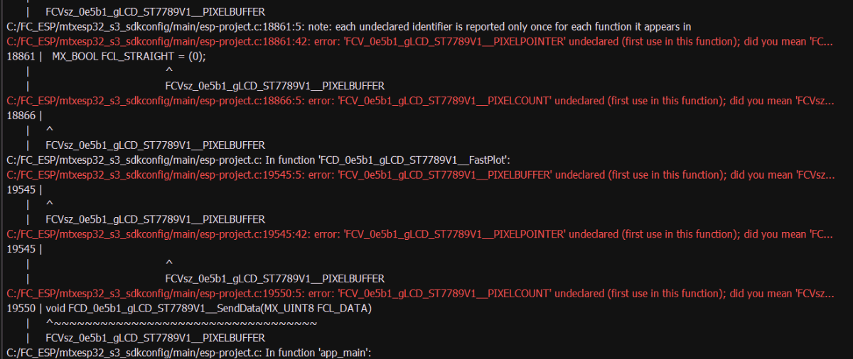

as if the buffer isn't being cleared. There's also a small problem. When I set Queve to “no,” I get errors during compilation.

Thanks for letting me know I have hopefully resolved the compile error now when the queue is turned off.

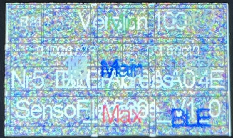

When the queue is turned off it's working now and much slower.
The pixel size with 480 instead of 240 is not working.
it's like this:
it's like this:
