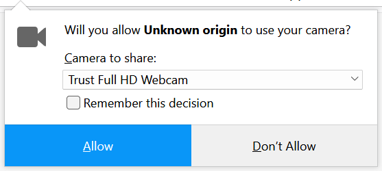

I think when the web app asks for permission, you can choose the camera then.

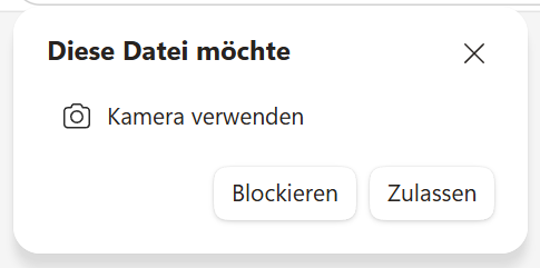

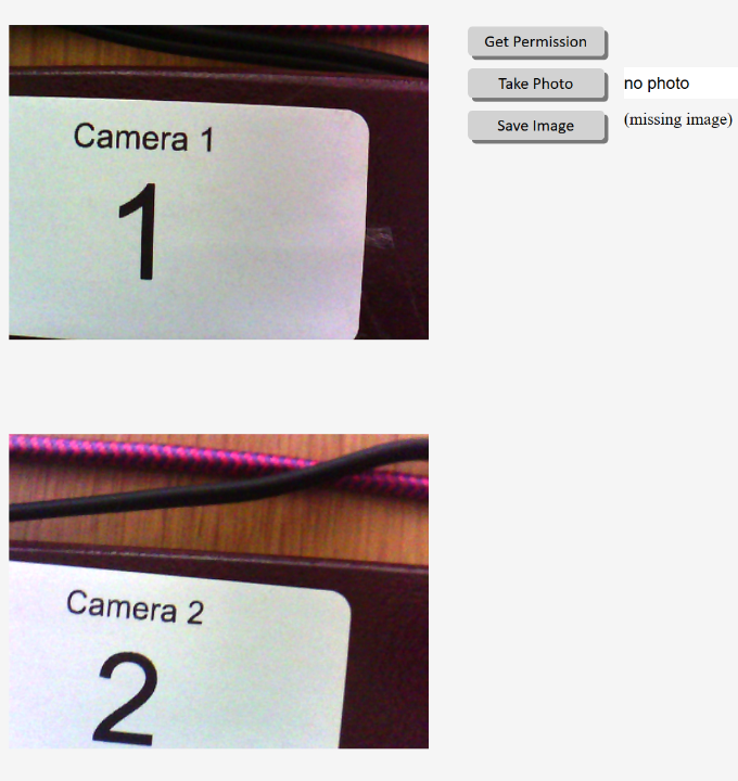

Firefox ask for permission, and which camera Edge ask for permission, but not for which camera For the Edge The camera you can choose if you type in edge line_
So I can use 2 cameras at the same time
I added a second camera to the Web Appedge://settings/content/camera
