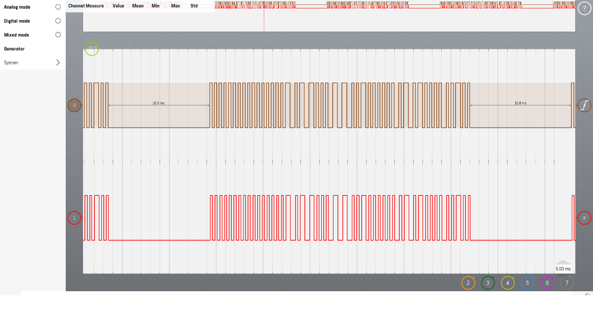

First up - using a UART doesn't work (needs inverting) - so I did a small transmit that uses TMR2 to generate 4000Hz (250uS) timing.
It's a little 'clunky' at present - data is put into 'buf' and 'length' set to it's length (in bits) - the data needs to include the 0xAA or 0x55 AGC bits - but because it is Manchester encoded - this is actually done as 0xFF (two bytes of 0x0b0101010101) or 0x00 (two bytes of 0b10101010) -n encoding gives 0 -> 0b10 and 1 -> 0b01 (which makes decoding the signal easier (maybe))
This doesn't do decoding (yet) - need to pull another Arduino.
This code is Arduino specific (there is a custom interrupt to get a 4kHz timing)
So - something to try out. I found an aerial helped (and I just poked a jumper through the relevant holes - solder later!)
Showing 'sent' and 'received' by connecting the data pins of the transmitter and receiver to a logic analyser (which works better than a scope - the signal is rather noisy)

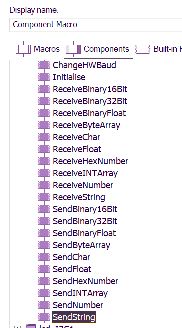

Finally, get some time to have a look at your program. Instead of using UART, can I use a I2C Display and I have tryed to connect it in the DEC and is it the correct place I have placed the macro?
Honestly, Martin, I'm not quite able to follow your program (only for hardcore programmer
). In your examble I assume it's a test to see whether it's possible to send and receive data, and I'd be more than happy to test it. However, my goal is to be able to use commands similar in the same way as with a UART component, as shown in the attached picture, so it's easy to choose what to send and receive.
I'm very grateful that you're taking the time to help me. Thank you very much for your support.
